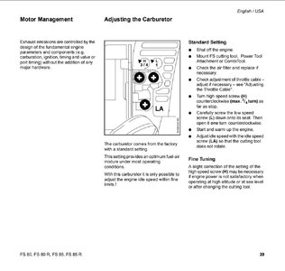

Hello everyone, I will apologize in advance if my post is long winded. I recently inherited a Stihl 4112 series FS80AV brush cutter from my dad. He always took good care of his equipment including draining the gas tank and running it out of gas. I replaced the spark plug, fuel filter, gas lines and air filter with the hope of removing any potential issues early on. I can get the machine to start and idle but wants to stall when I throttle up. I attempted to adjust the carb per the Stihl repair manual with no success. Kind of an odd thing is, I found if i mess with the plunger on the bottom of the carb I can throttle up no problem but if i stop it goes back to wanting to stall. I'm guessing that a carb rebuild is in my future. Has anyone had any experience rebuilding a TK carburetor for this machine and are there any pit falls that I should be looking for as I do this? Any help that you can give me would be appreciated. Thanks
