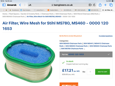

That air filter in your pic, is .. from what I understand is a winter air filter. ?
They work great but let the fines in. Well mine did.
I had one on my 660 when I brought it 2nd hand, although it ran great i didn’t leave it on there long, because of the fines
In this pic from LS engineers it shows a foam insert, mine wasn’t there. And I did know what I do now, that’s why it’s still in a box
