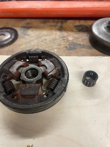

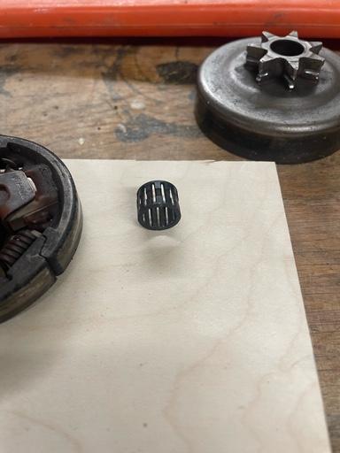

Here is a couple pics of the clutch and bearing.

Clutch looks like it got a little hot but still serviceable, if it were mine I'd definitely install a new clutch drum/bearing and some clutch springs.
67L36Driver
5:30 AM
596
9,488
40,068
Set of springs at my favorite Stihl dealer is $5 out the door.
Good investment. [emoji106]
