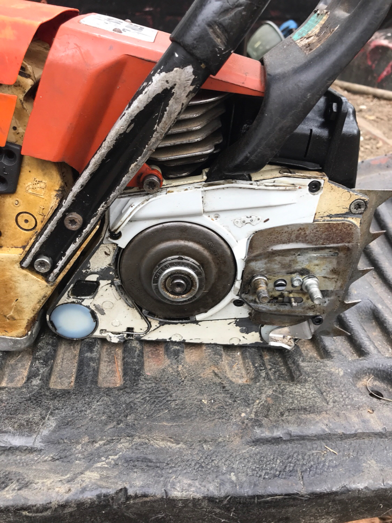

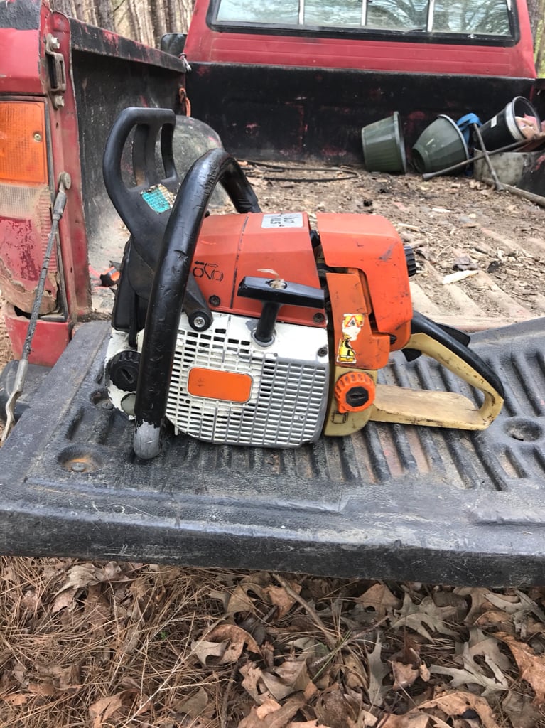

I completely rebuilt the saw. It is all oem except for the air filter.
New piston kit
Bearings
Gaskets
Seals
Etc.
The saw has 150 psi compression, but it has an ignition timing issue. It will jerk the rope from your hand and won’t start. It has broken two starter ropes. The gas tank does not leak but it has a small plastic patch on the inside. Two part plastic was poured in and allowed to setup inside the tank (upper corner). I’ve repaired several tanks this way and it always works. $350 plus shipping. I’m ready to move on to the next build.
