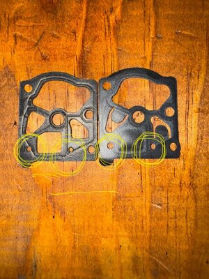

Just got this 028 back to running condition and then this happens.
The saw excessively floods on the 1st or 2nd pull and sprays out of the exhaust.
I just did an entire carb rebuild
Carb is a WT16B
Does anyone have any idea as to what’s going on?

I would suspect that the carburetor is leaking through. Do you have the tools to pressure test the carburetor? If you changed the needle, sometimes a new needle seals worse than an old one if the seat is worn. I just had a MS260 that had a pitted/corroded seat (despite being chrome or stainless, whatever the shiny ones are made out of). I would guess that 028 has a brass seat, which can wear and corrode much worse than the newer shiny ones.
Or a defective pump diaphragm could be causing the same issue.

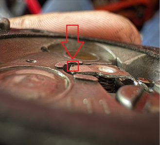

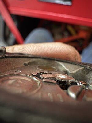

In the second pic, looks like you have a bur on your rocker arm, if so, need to file it flat, the diaphragm could be holding the rocker arm (needle) open just a little, enough to flood.
When starting, are you using full choke or not? If you are and you are in a flooded situation, put it in run mode (no choke) and give it about 20-30 pulls, see if it clears the flood and starts. I would file that bur first or you may just be going back and forth with it.

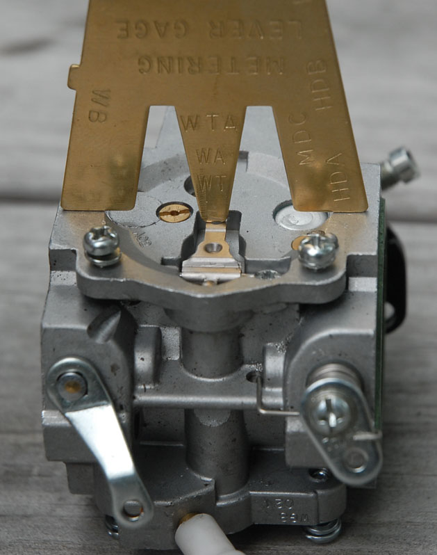

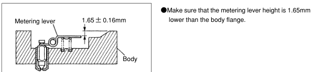

Is the lever about 1.65 mm below the carb body casting?
I picked up on that and he has removed the burr.
the metering lever is flush with the body of the carb as depicted in the diagram
The carb is definitely leaking.
It’s not the welsh plug as I sealed that as a precautionary measure.
Being a STENs kit, it is possible that the metering diaphragm is out of spec, I assume that’s what you meant, not the pump diaphragm.
I no longer have a MityVac to check for leaks or pop-off
I'm not sure I understood you correctly. Is the lever flush with the body or 1.65mm below?
No, I meant the pump diaphragm. If there is a perforation in the pulse chamber area, it will leak into the crankcase. That's not very likely except with the thin plastic style diaphragm.

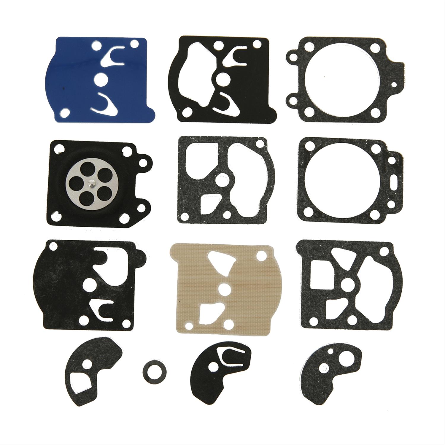

That pump diaphragm is incorrect. It should be solid instead of having the large cut-out on top. Usually there are more than one kind that come in the kits so the kits work on more models.
Sloughfoot
6:29 PM
26879
Jun 7, 2023
631
1,546
Norcal

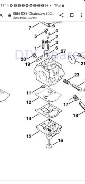

Like #12 in the ipl above?
