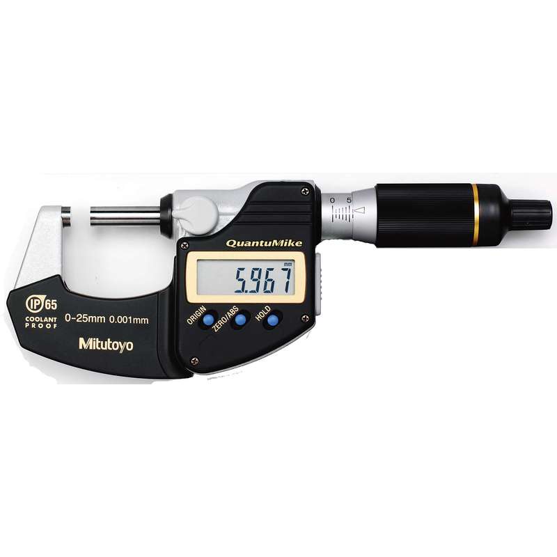

Buy this
ABSOLUTE Digimatic High Accuracy MDH Micrometer 0-25mm / 0-1"
