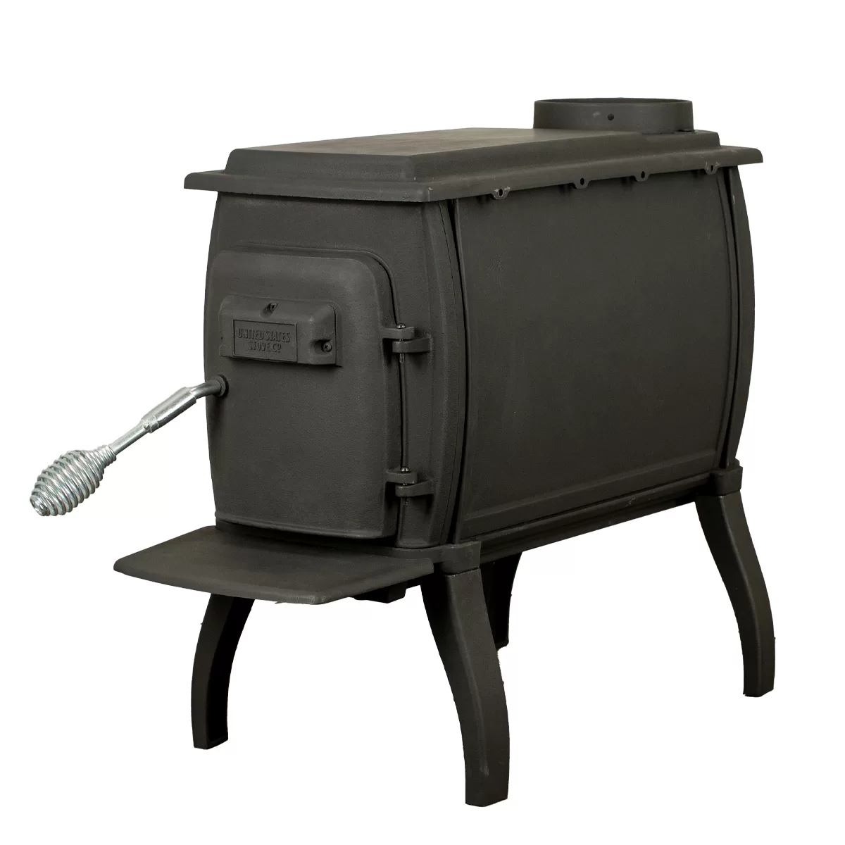

We ran one of these ( not exactly same ) in our house addition for like 20 years on mostly pallet scraps. It heats very well and is fairly small for a wood stove. It would cook that room even dampened down.
If you need smaller than that look for a "guide stove" It the kind that goes inside a large 8-15 man tent. They are really small like the size of 2-3 boxes of boots. Here in PA there is a plethora of great used wood stoves on FB for under $400-500. That Drolet Bistro is pricey if thats what you really need. If your looking for a food warming box-stove scenario any large metal lid that will cover the ceramic plate and food without touching will work, even a big deep cast iron fry pan will do.
Otherwise IMO if you have a welder just take a day and make a lil one out of some random metal scraps and a +10" steel pipe or square tube for the body. Heck Ive seen guys weld up little bot-belly stoves out of two old truck brake drums and steel scraps. As long as its semi air tight to be able to control the draft and you can put fire in it, it will work...... a DIY stove falls to: how safe do you need it and how much do you need to place the blame on a manufacture.

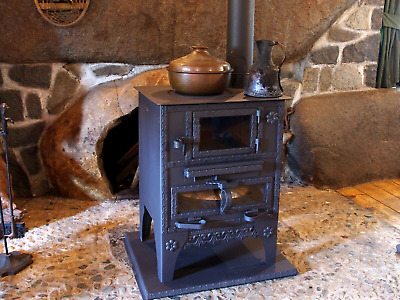

This Drolet Bistro is pretty smart with the stainless oven and cook top. May have to sell accounting (better half) on one of these for our place.

I think you maybe looking for something that will not work for your particular needs and square footage.
I’ve cooked on a wood burning oven/4 burner stove and they are difficult to keep at an even temp. It’s either full throttle or almost too cold. You have to use small chunks of wood to keep things right. Witch is not efficient or good for heat especially when ur outside for a few hours. I still think a 1/2 steel plate like 24x24-30 on top of the first stove I showed would be great. Plenty of surface area for 2-3 pots n a big coffee pot……and it be cheap
