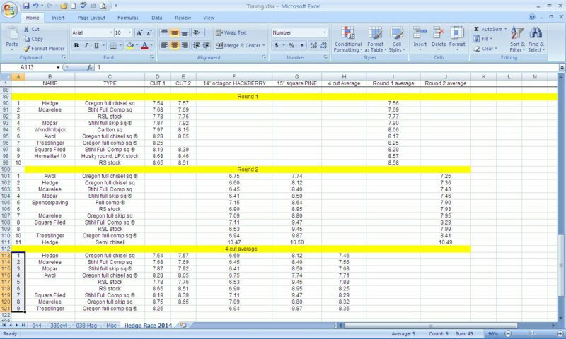

This is why i keep preaching to slow the chains down for work .I learned a lot from that thread .
Somewhere on FHC. I think me and Matt were the only 2 to beat new chain. Everyone else was too aggressive and pulled it out of the powerband
Any chance of getting a link?

I'll save from going over there for the rest of you
