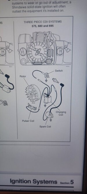

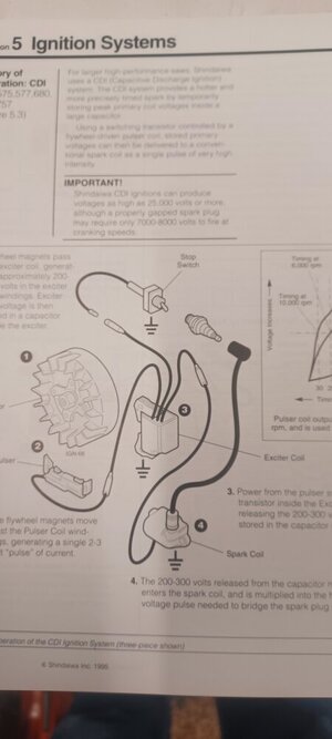

The "spark" coil tests good and the pulser test good. I must need the exciter coil. Hope one of yours test good.
