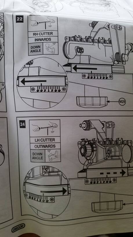

I called oregon yesterday to confirm this Eric. You have to do +10 on one cutter and -10 on the other. ...
^^this is for the hydo 551462
Sent from my SM-G900R4 using Tapatalk
Interesting. I might do that to a chain and see how much of a difference it makes. I've always left it at 0. I thought you'd move that if your wheel was getting small, but cbn's don't get smaller.

If you're using vise tilt, its easy to remember if you think "right away". Right hand cutters you tilt the vise knob away. Left hand towards you.
