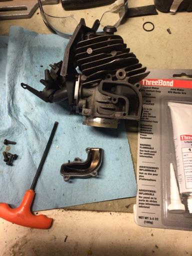

This is probably a dumb question, but what is the recommended way to seal up transfers?
I had a steady air leak on the transfer, confirmed by dunking my 562xp in the tub while pumping in air.
I have the transfer off and cleaned up, the o-ring seems good, and a fresh tube of threebond.
I assume I put a light coat on the jug and in the groove of the cover, then insert the o-ring and assemble it. Or?
Why doesn’t Husqvarna offer replacement o-rings/gaskets for these? I know I’m not the first person with a leaking transfer cover.

I make sure both surfaces are clean and smear a little bit all the way around the O-ring. Insert it into the groove and screw it on

And to the OP, some sealant and some blue Loctite on them transfer cover bolts.
