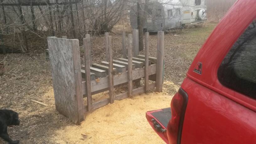

Star Prairie WI
Here's mine, kinda purpose built, but it's adaptable if need be. More pics and an explanation of what I use it for here: http://opeforum.com/index.php?threads/1654/
