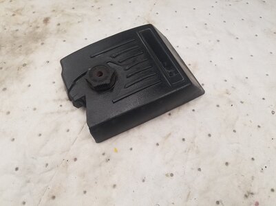

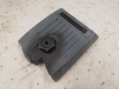

In some cases, the judicious use of a heat gun will restore badly faded plastics.
I used this already cracked cover as a test.
