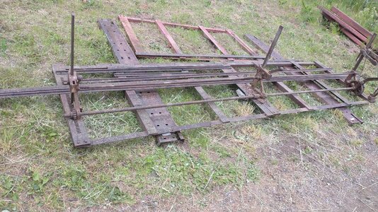

since I aint that good at fixin chainsaws I thought I'd start a build thread on getting an old circular sawmill put back together and cuttin logs.
so heres the start of it, I spent the morning today retrieving various parts from a few piles scattered thoughout an old farm.

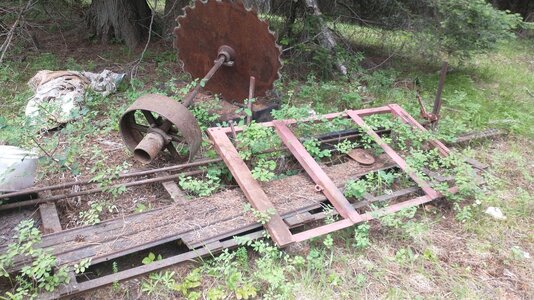

heres the 1st pile that contained the blade and the log carriage.

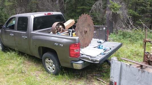

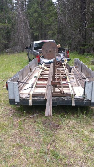

got this stuff loaded up and next week I will go fish more parts out of other piles

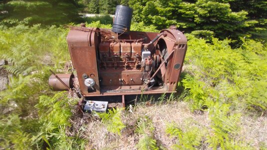

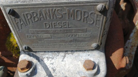

heres the old Fairbanks-Morse diesel motor that powers it, I still havent drug it home yet.

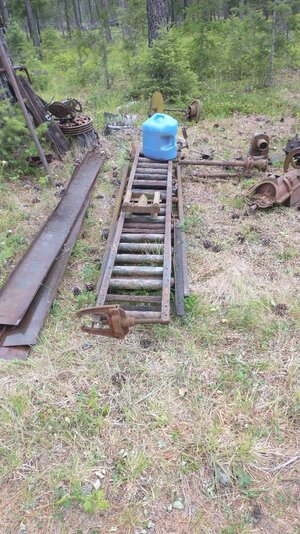

I did find some roller tables and other parts I didnt picture earlier, so heres the pile so far. various sprockets and gear boxes for sawdust conveyor, and other misc stuff I found that I may be able to use.

Ive spent the weekend spraying everything with diesel, and trying to find info on the motor, so far very little info, I have a few parts supliers i use for the old stuff when I work on it, so tomorrow Im gonna make some calls.
if anyone has a line on new/used parts for that fairbanks morse 36A I would be very interested in knowing about them.

PTOs run clockwise as most industrial power units are counter clockwise.I have seen them direct coupled from PTO to Mandrel with a Drive/PTO shaft. If the blade is insert tooth make note of the tooth pattern as C and D are not so easy to find and #3 are getting that way, Your Fairbanks is a 1200 RPM and your 471 will be 1700 to 1900 rpm. your mill appears to have been run flat belt drive from an old tractor. (Think SC CC Case)

the fairbanks unfortunatley is not going to be used, it has had alot of water get into it and parts are very hard to find.

One very common mistake I see is people put the GUIDE TRACK next to the blade. it really needs to be the far track and the flat (Weight bearing)track and wheels go near the blade.
