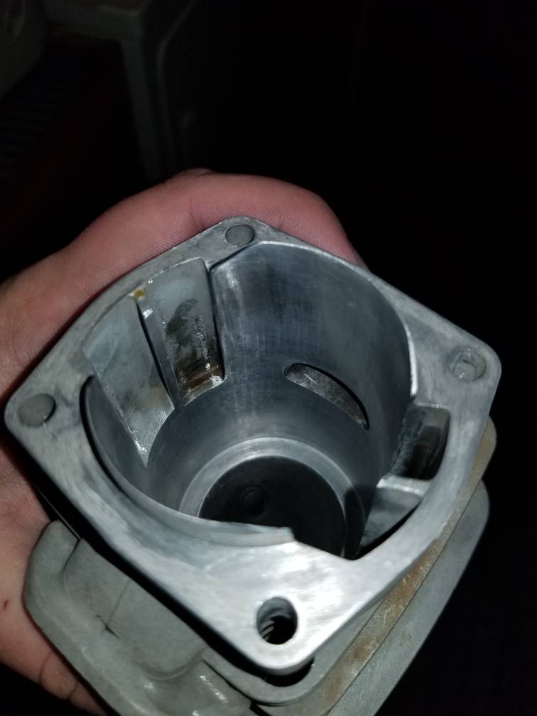

Bout as good as it's getting. Now to make the rest fit. And check port timing.

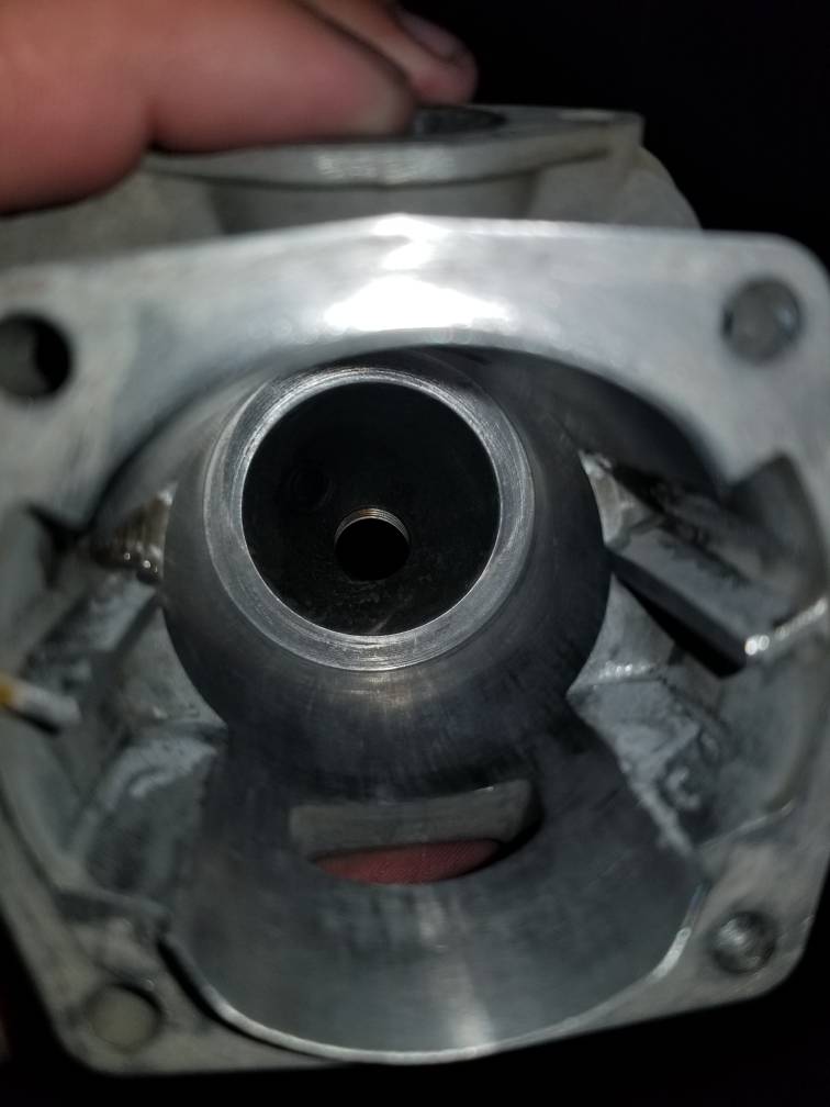

Well this project may be on hold a bit. 371/044 pistons are a no go.
Have to make spacer for the jug to get them to fit. Was trying to avoid that. Cause of all the other mods required to make it work.
If the chamber/piston crown could get me the .130" I need. Then they are free porting that much.
I guess the jug is ready for a sleeve at least... may even take it back to 45mm just to see how the iron sleeve acts in a saw.
Sorry to disappoint. Not gonna have the time to do the required modification before hea ding back to work.
If someone knows of a shhorter piston than the 044 let me know.

How much shorter than an 044 do you need?
2 mm will get me in the ball park. with a longer skirt.

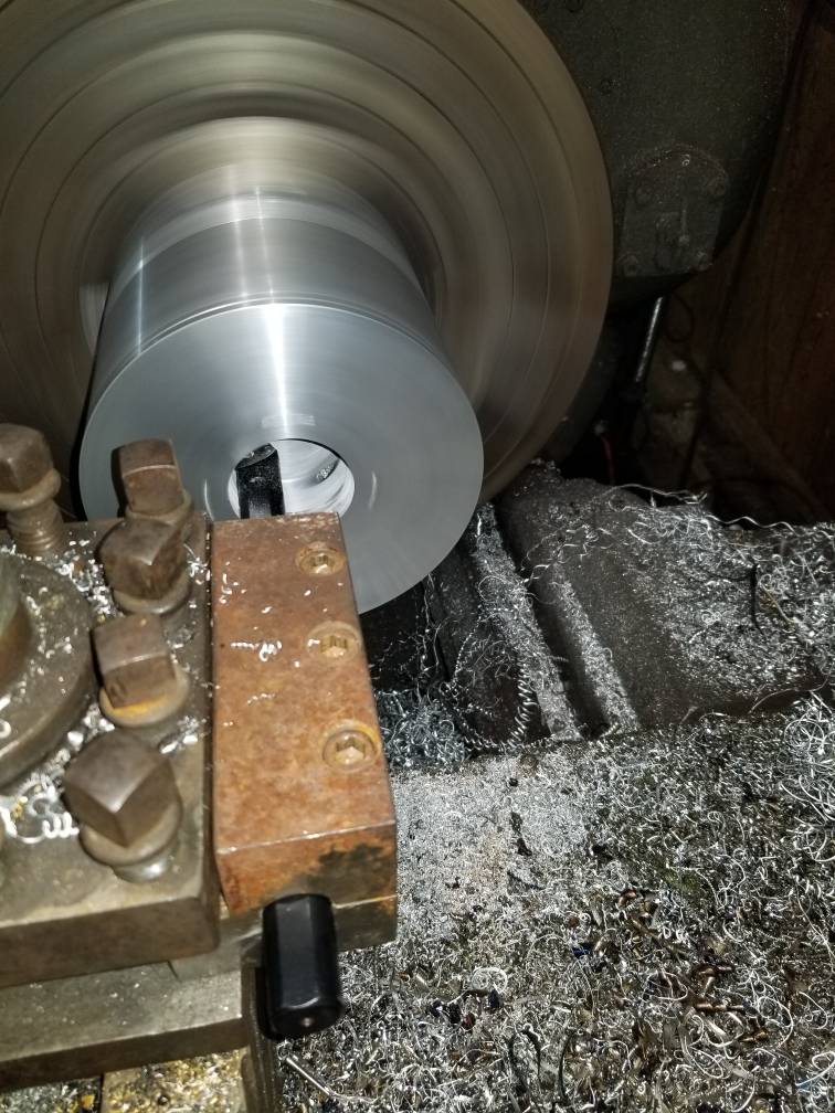

Screw it. Well see if it will hold 52mm as i already have the sleeve material.
Waiting to hear the rattle of the top half of the jug rolling around in the fixture...
