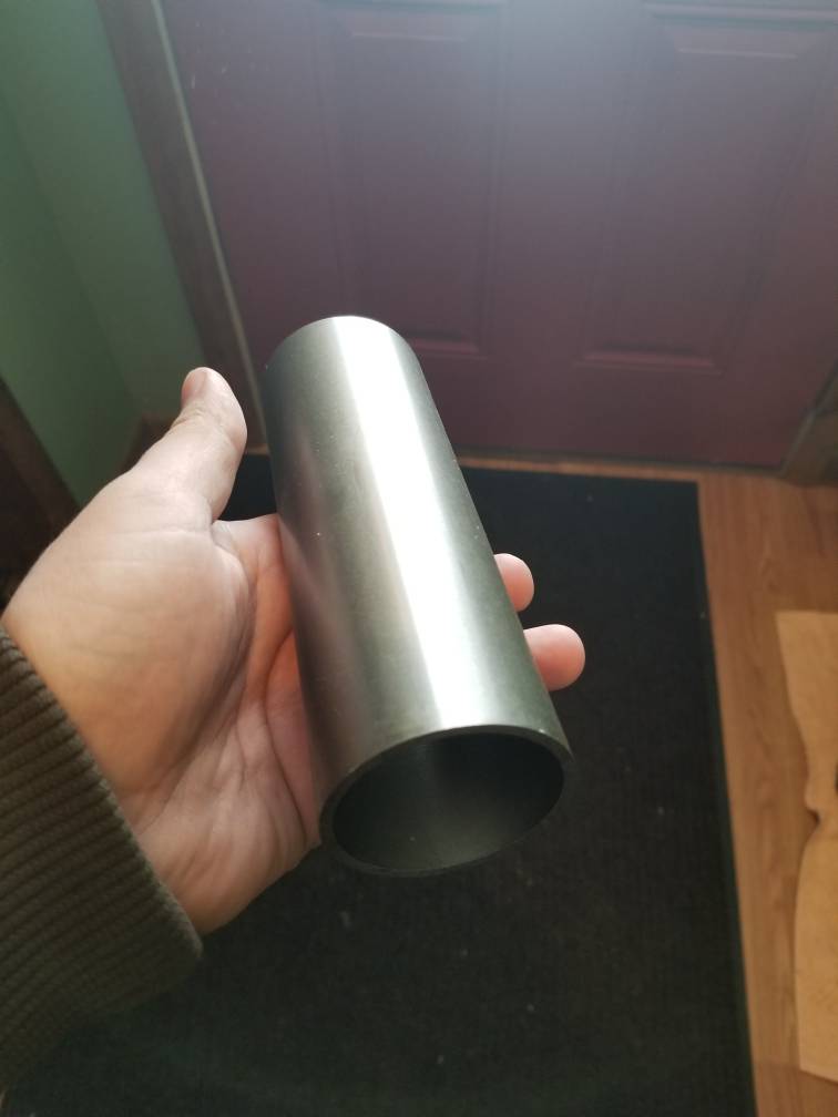

I still have to try the iron sleeve first. And no reason for a 2 piece head.
