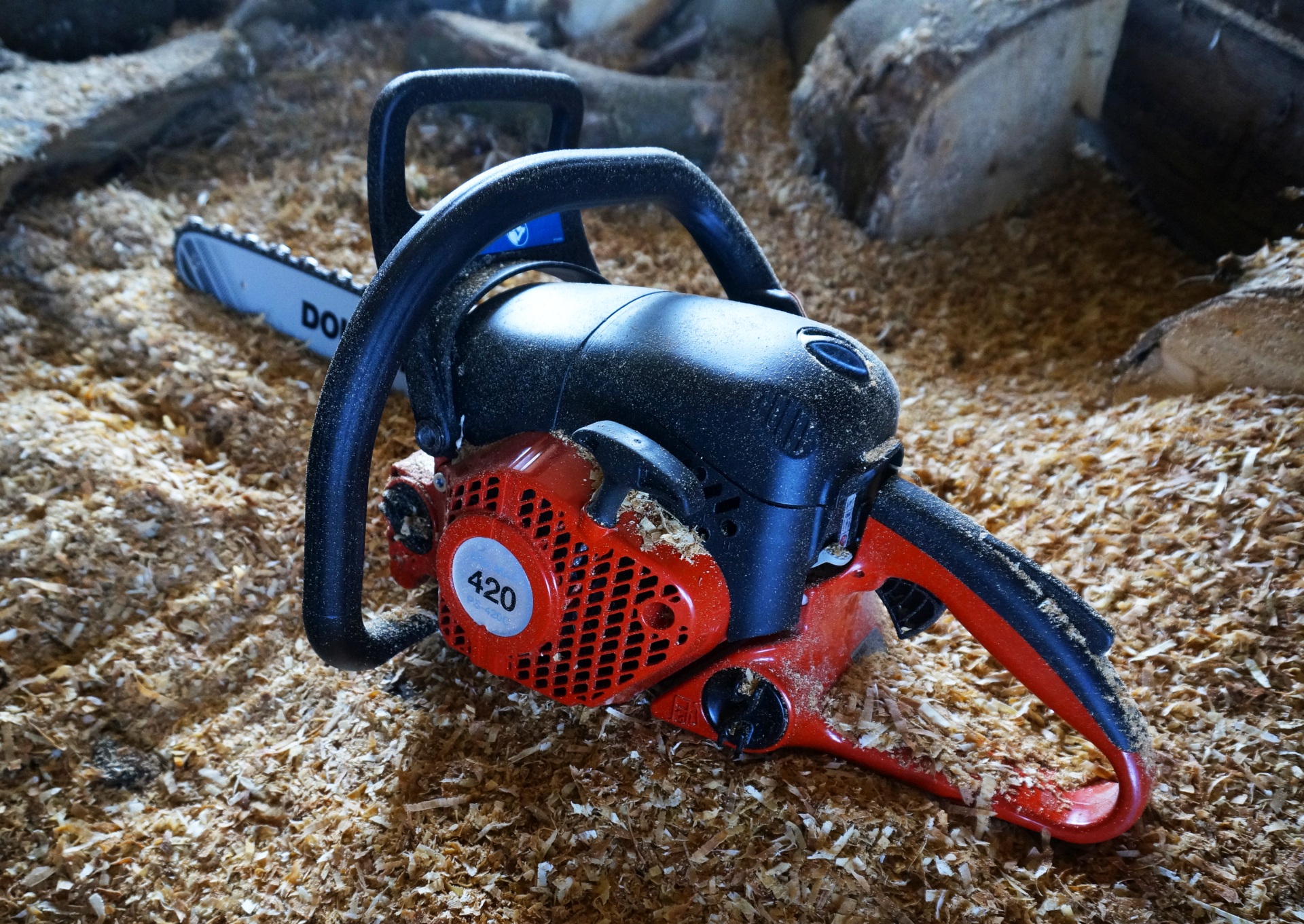

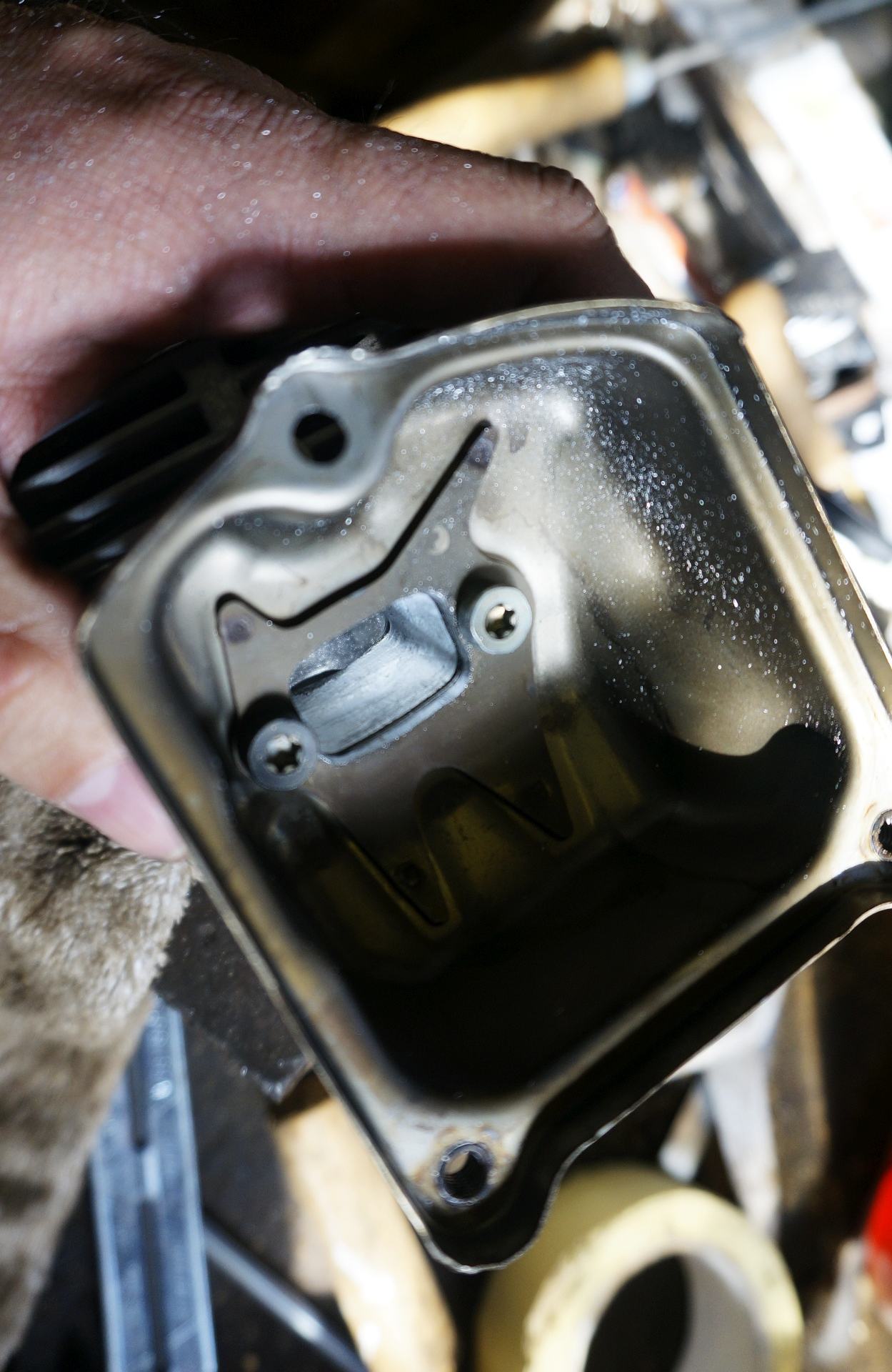

Well, the intake and exhaust are much more aggressive. I made the exhaust sort of like a horn - like the exhaust you see on KART engines. So much of an angle that the gasket only fits one way on it. It also has more timing on both ends. I sloped the intake more downwards than the 420 you have, and went with more intake timing and less width. It seems to allow the saws to run richer from my experience. I've also done the same to my 044 and 288. Also ventilated the cover quite a bit. My 044 and 288 are stupidly loud, tho. They have huge exhaust openings. It not only helps with power, but it keeps the saws cooler. I have two outlets on this 4300. I think your 420 just has the one.
Your 420:
Your 4300:

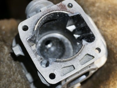

Here's a pic of the modified primaries on the Donormar cylinder. On the Makita cylinder, I used a trapezoidal bit, so got a much sharper edge on the xfer, which allowed me to make it a bit smaller mod than you see in the pic(shorter with less slope needed in the primary) - so more velocity/pressure and less intrusive for the rings. But it looks similar to this pic, just a subtle difference. Randy always says to keep the top of the xfers tight. So I decided to go with that. I also added about 1.5* of timing to it(mostly to preserve the ring, really), and massaged the bottom of the cylinder a bit differently. I did not touch the other xfers. Yet. I wanted to see how the primary transfer modification would affect the operating characteristics first.
So the primary xfer modification/finger opens at 17* ish after the exhaust down to 19* for the main xfers. It is a smaller amount of timing even than it sounds because the finger is basically a tiny triangle pointing at the intake side. The tip opens at 17*. So it just starts the swirl and helps the exhaust scoot while the main part of the primary and xfers bursts open at 19* and floods the chamber. Exhaust at 110.5* ish with a roof to it, and intake at 75 - but it is a markedly different intake mod than in this pic(which is 73*). It is not as wide, flatter sides, and sloped downwards so the charge doesn't have to change direction so soon after it leaves the manifold. It all is going one direction now - directed more towards the crank. The exhaust opens conservatively at first because I didn't want to flatten the roof any over stock, but over all the exhaust on this jug is nearly half again the width what it was stock at the exit port. So the flow should be much faster. It definitely sounds like it.
I'd also like to note that the plating on the makita was much harder or thicker than on the donormar. Also, the compression is slightly higher. Dunno why. Maybe more squish. This jug is def a slightly diff design than the old 420 was, including a different(smaller) plug as well.
