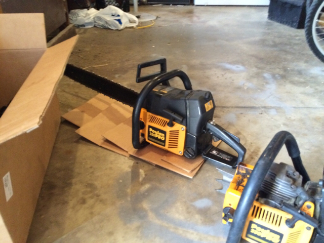

Here I am looking all over the web for parts and I score a 100% runner at the local pawn shop on the way home!

Sweet - so tells about the great deal- did you contact the CL I sent ya?

I thought about that too but was trying to get out the door at work.
65 out the door runs, revs, oils, and and brakes

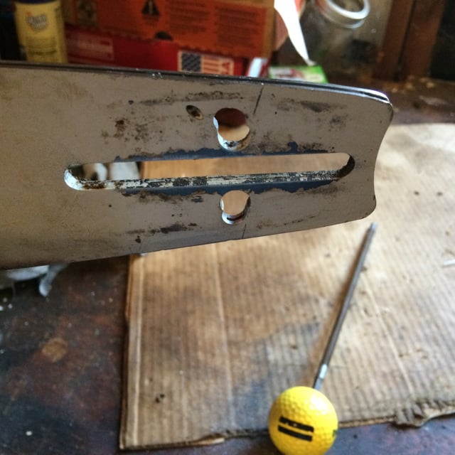

Anyone know if there is a thread on modding the K095 mount bars to use on these saws?
Just elongate the bar tensioner holes out till you hit oil channel in bar real good. ;)

I was just looking for 3450 parts saws last week to finish off 2 projects I been stealing from, when I came across this one.
Oh well other 2 still waiting. :p

K095 bar on the K041 mount. About 20 mins with a 7/32 file or a dremel like I said above. I just use a file anymore.

Does that look about right?

Yep the bottom one is more what I try and do.
