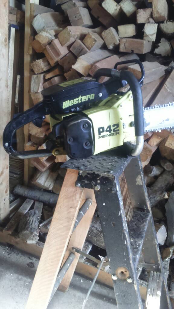

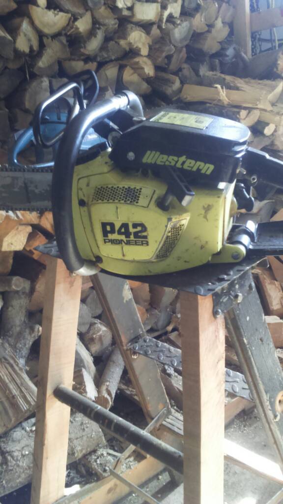

the 41 has the light yellow and the 42 has the darker yellow same as the 39 52 and 62
Not necessarily. There are Pioneer P42s and Pioneer/Partner P42s. Same with all the others.the 41 has the light yellow and the 42 has the darker yellow same as the 39 52 and 62
Yes, that was built after the merger with Partner
Still kicking myself for selling that one to you...
Yeah I hate the POSStill kicking myself for selling that one to you...
It depends if it is a green p42 or a yellow p42. The green p42 is basically the same as a p41 with a different carb,fiberglass reed, and a faster ignition. The yellow p42 has different port timing, and everything else the green p42 has.@p61 western i think ports are different or the reed system is
It's just cribbing that comes under bundles of plastic pipe. I bring them home from work. The trough milled into them is to keep the metal strapping from sliding offMy apologies for the sidetrack, but I'm curious; what are the pieces in your wood stack with router work originally from?
