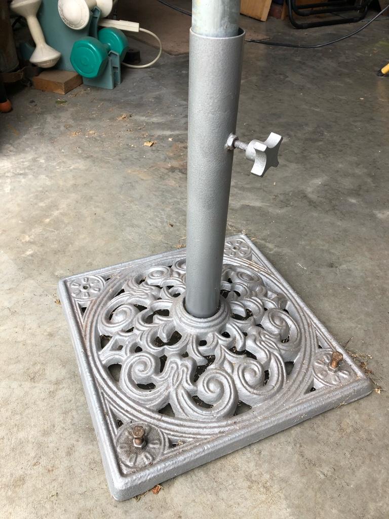

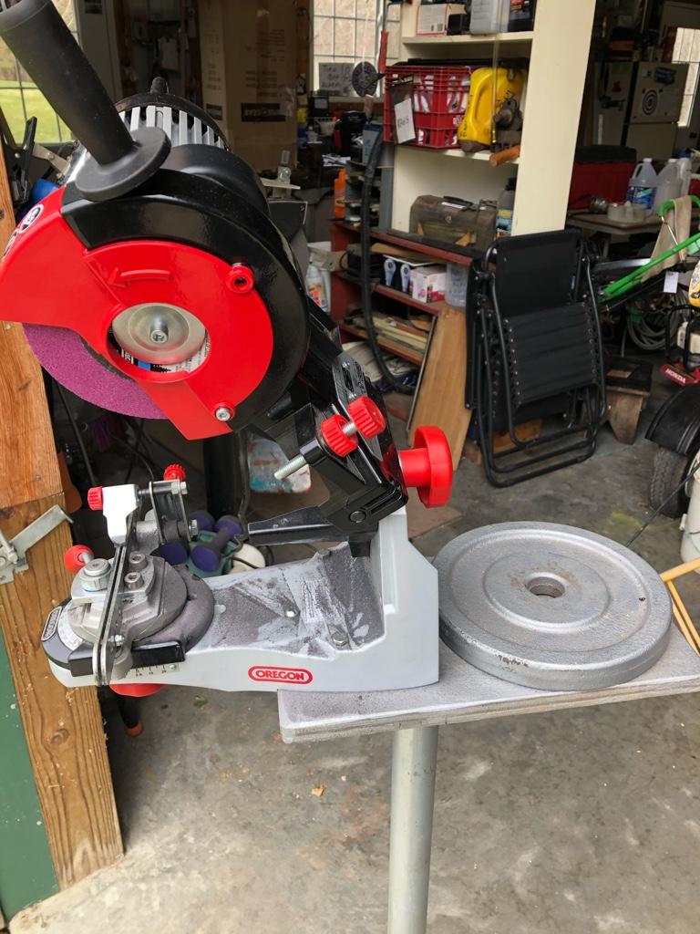

Recycled stuff turned grinder stand. No trips to store. Base is from a patio umbrella that wore out.
