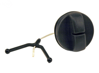

Looking for an oil cap for my recently acquired 2101xp. IPLs show 2 different caps so not 100% on which I need. Not much local dealer support around me. TIA20240511_205201.jpg20240501_181724.jpg

The number for the oil cap is 501564504 which is a vented gray cap and not compatible with the fuel cap mentioned above (non-vented). The 2100 and 2101 had a vented fuel tank and unvented oil tank, hence the need for the two different caps. You can also use the slightly easier to find black version (501564501, 501564502, 501431301, or 501412501).

Awesome! Thanks
