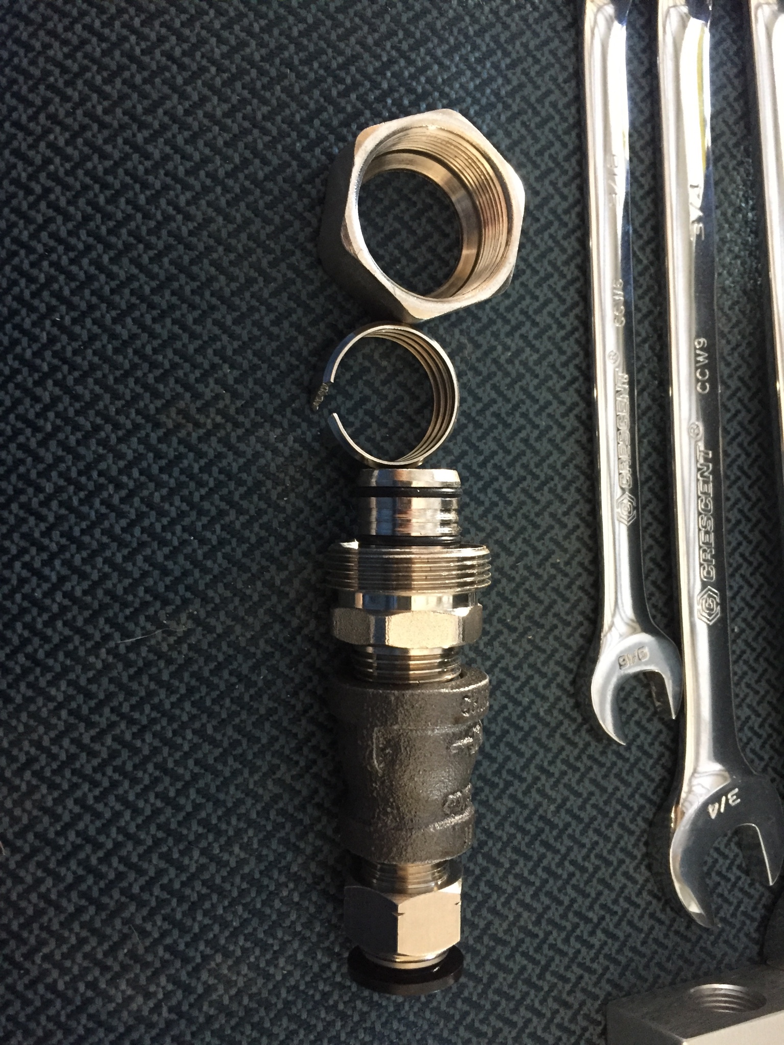

Has a aluminum core to handle 300psi.
But I think it is the same material as water line pex.
Sent from Hoskvarna Hills
Dam 300psi ! The compressors we have work are only running 120 lol

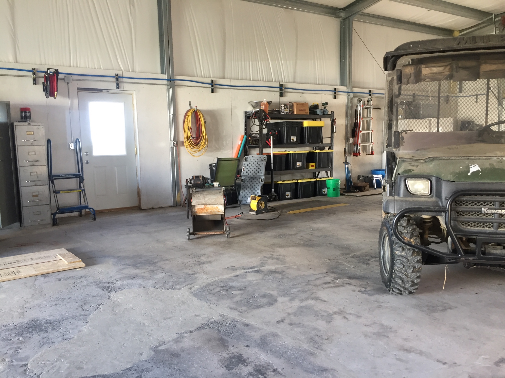

Let us how you like that Mark. Im going to be in the market to plumb my shop.
I like it so far easy to work with.
I put 3/4 on south wall for volume then will come off that with 1/2.
The only thing I see is they don't make a good set up for reducing to the 1/2.
Have to do this
Those fittings are pricey $11-17 per.
But better than working with black pipes.
