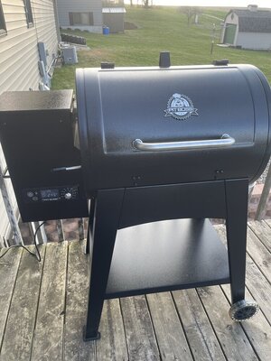

They turned out good. This grill is going to take some getting used to. I’m used to direct heat on the Weber Charcoal grill. It was like they were taking forever to heat up, then WAM they were almost over done, almost… I caught them just in time and they ended up Medium. Worked for me and the boys tonight.

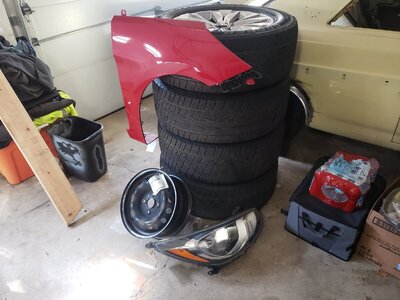

I'm done working on Korean rickshaws for the day. Went to one junkyard and one auto parts recycler today, picked up a rim, a headlight, a fender and inner splash shield.

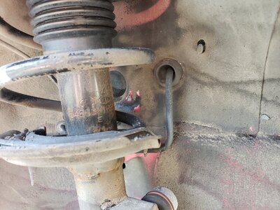

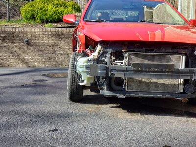

Came home, pressure washed the engine bay and around the fender where I'm working. Pulled the wheel off to figure out why the camber is so out of whack. I think the strut is bent. I measured the frame and upper rail over and over, and it measures straight. And there is no sheet metal bent or buckled. But the camber is way out and the strut is about half an inch closer the frame rail than the other side. There's a witness mark where the strut hit the inner rail.
Worst case Ontario, if I can't get it into alignment with a new strut and control arm and camber bolts if needed, I can put it on my buddy's frame rack and get it straight.
View attachment 416299View attachment 416301
same color fender ?
