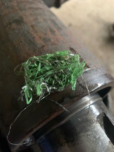

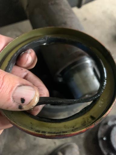

Here’s the culprit that took out the seal on the bobcat axle
Round bale netting
Wadded up and broke the seal
