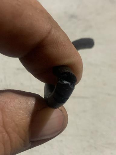

Working on a 066,036 and sharpen 7 chains
036 would run then die start back up and run and die. I don’t see how it run at all

I bought a 036 that the impulse hose wasn’t connected on carb side
Helped on the price lol

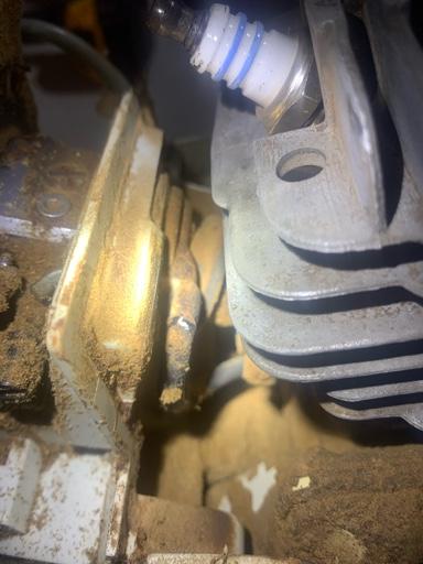

The 066 I worked on couple yrs ago
Wasn’t running right so took it to the local stihl dealership they put a carb kit and fuel line. I don’t think they even started it after
His buddy he cuts with said to bring it to me I’d figure it out
Took muff off and found a clean spot at cylinder base about 1/2 in wide
Cleaned up
New gasket and new piston and rings run like a top
Now fuel line cracked. I don’t think a new line was installed. Should last longer than 2yrs
Cleaned up
Sent from Hoskey hilltop
chinese aftermarket hoses are like that
lucky to get 2 years out of them
