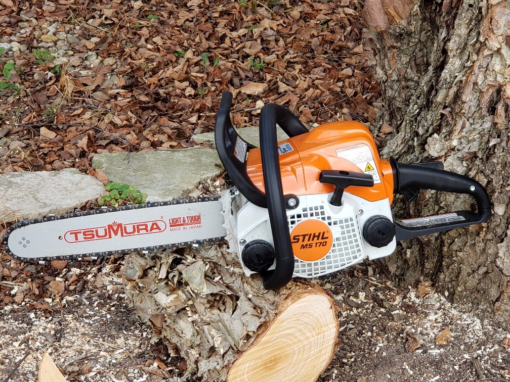

The ms170 probably came with 3/8" picco or low profile. Oregon 183PXLBA074 is the number for a .325 pitch chain that could fit. Nothing listed for a 18" oregon 3/8" lp. I use a poulan pro 530-044693 18" bar on an ms250. Not sure if it is supposed to work, but it does.
View attachment 320915 View attachment 320916
That's a saw that needs some love. I run 14" .050 gauge 50 dl. It is to low profile. Handy for me, same set up on 020 T top handle. New Tsumura bar cheap on the Bay.
Clean your saw BRAH! Lol
