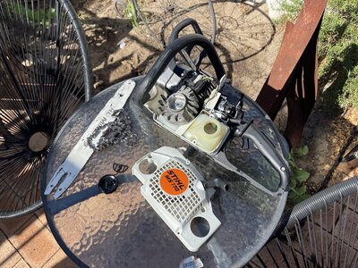

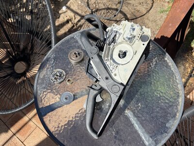

I got my hands on an ms 170 and here at sea level it was bogging badly off idle and max rpm were between 15,000-15,500 rpm. Running 50:1, a dull chain and aging diaphragms wouldn’t end well, it’s just a disaster waiting to happen for the future customer, especially here in Australian heat. Hopefully the new owner enjoys using.
The local dealer let me rummage upstairs and let me have a used WT215 for free, I just needed to install a new main nozzle.
It was a good oppertunity to do a short video at the same time.

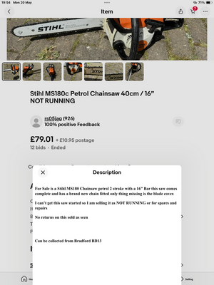

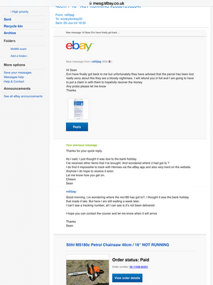

Oh,
This thread got my cad going, I thought I got over it 🤦‍♂️🤷‍♂️
I saw this saw and next thing it’s mine 🤪
I guess, when it arrives I will give it the molesting it needs
Here’s An update for you guys.. I don’t know if I,m happy or sad 🤣🤣🤣
Well guess what,,, the fugging courier has lost the parcel 🤷‍♂️👎
