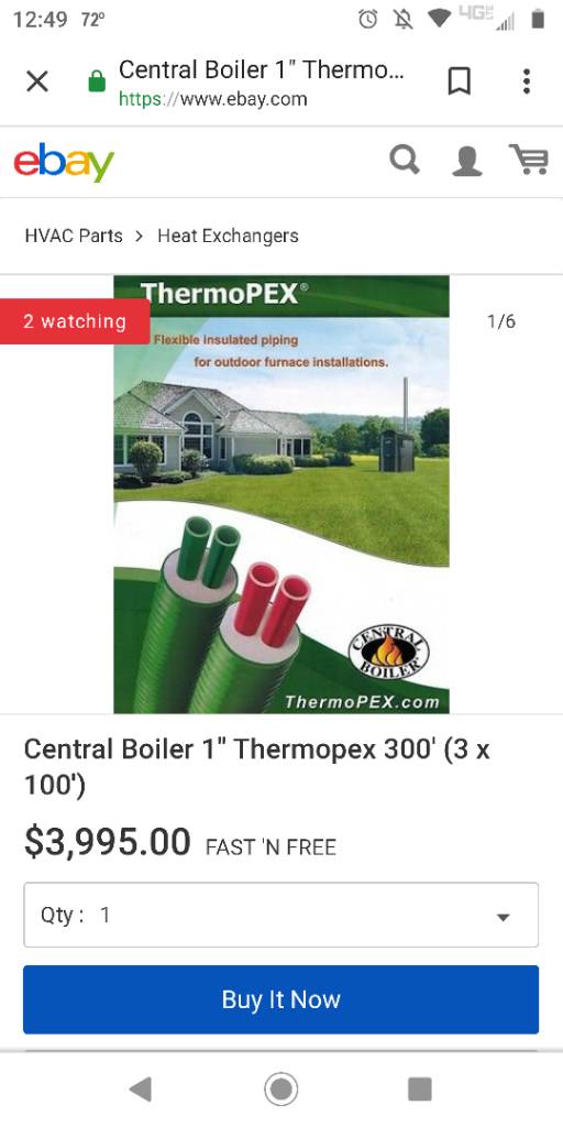

I understand that it's expensive but if you want to stop heat loss this is the stuff to get. It's better than foaming it in the trench and anything that's been wrapped etc.
