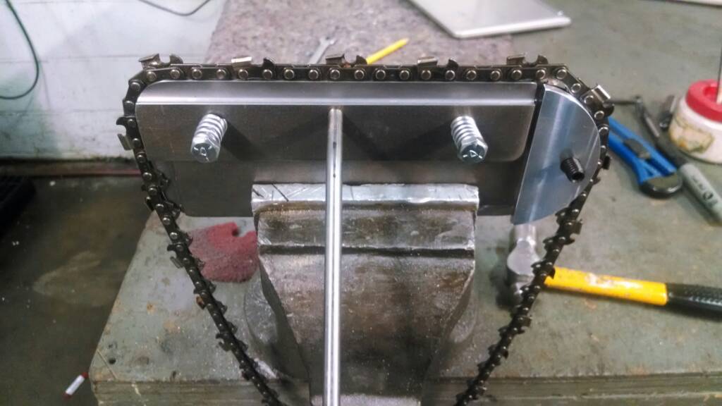

Here is the new less expensive short version.

Who here would use it in high volume? I am thinking of sending one for review.
Philbert, Mark, pros: its less expensive 60-70 shipped, less moving parts. Cons: its shorter so there is 2 cutters up not 4, it won't grip as tightly for EXTREMELY heavy handed filing.

I could be your test dummy. I still prefer your original.
