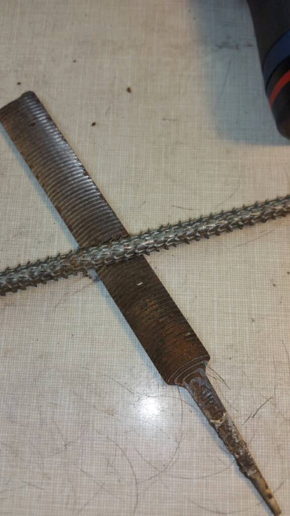

Ready to port these mfers.......
Got a couple new smoother ones....lol
