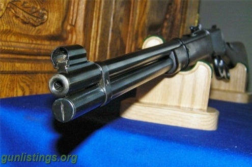

that black part sure looks like a front sight cover for a winchester rifle
Hello @old guy, thank you for comment. Did not know much about rifle but is it one like this, sitting top at the left end of the barrel?
