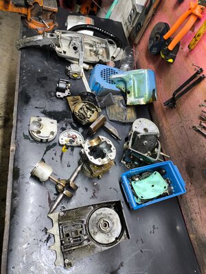

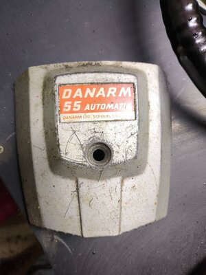

Olá.
Por gentileza, estou precisando do manual da Danarm 55 automático, comprei uma desmontada e gostaria de ver se não está faltando peças.
Desde já agradeço.

Quote, Google translation:
Hello.
Please, I need the manual for the Danarm 55 automatic. I bought it disassembled and would like to check if there are any missing parts.
Thank you in advance.

I have a note saved that says - "the 5r is a danarm 55 automatic right hand under a different name and the danarm 55 automatic is a mcculloch 2-10 with a tillotson carb made under licence by danarm.
Also attached are a couple McCulloch 2-10 ipls and service manual 63084 that is in the McCulloch publications guide. It lists the 2-10 as using the 63084 service manual.
