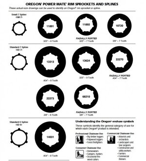

Does the 261 take the proprietary small size Stihl rim? I know the 034/036 did before Stihl did the drum/bearing upgrade.
261 does have the common 3003 bar mount, so no problems there
It takes the small spline rim but far from proprietary. In fact I have mailed 3/8 small splines to guys because their Stihl dealer would not order them.
Maybe if you switch the drum? It’s not the usual small spline you will find from Oregon or Husky etc. I have never seen one that wasn’t OE Stihl. Edit I thought the picture showed the Stihl rim for comparison. It doesn’t. Stihl is smaller than the small shown here.B31FAEC0-664C-41F7-B4B1-9BB2E2588992.jpeg
Yes, it takes a proprietary rim.
Bill, small spline is different in Stihl vs Oregon, you need to match drums.
The std/med spline drums match up.

I see the thread came up again. I know some think the small spline rims for the 261 are proprietary to Stihl but there are aftermarket ones made. Stihl also sells their own in .325 7 tooth, .325 8 tooth, 3/8 Picco, and 3/8 standard. I have them all.
