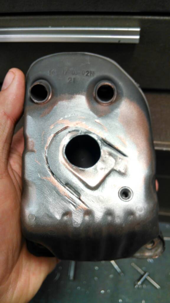

Hi all,
looking for any ideas on modding the muffler on my 2260. Can anyone tell me what has worked for you, save me the trial and error. Pics would be appreciated, Thanks.

Make the hole bigger. :)

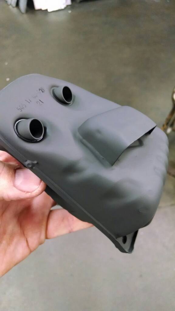

I've gutted a few and bolted or welded on a new deflector. Red97 had some nice ones for welding or drilling your own holes in and mounting.

here us my 2260. I would do it different if I did it again.
