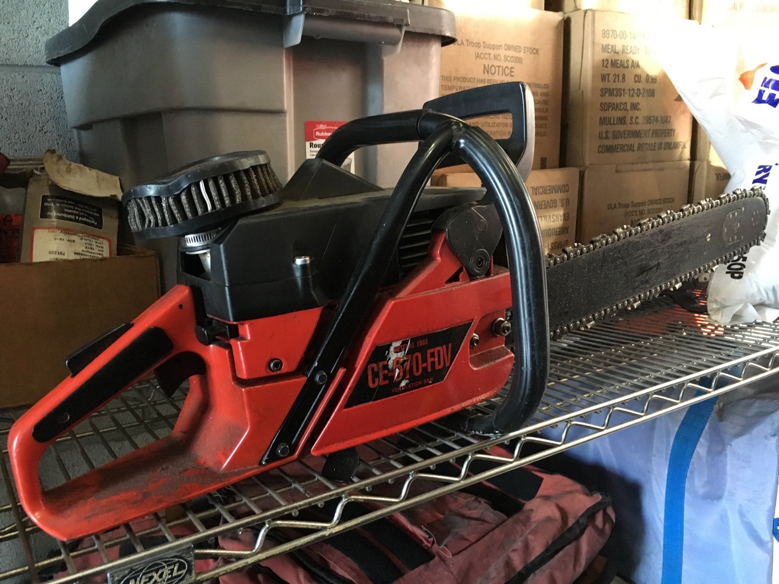

Our ventilation saws were Jreds. 2172 I think under Cutters Edge label with Bullet Carbide chains and big ass filters.
Sent from my SM-N900P using Tapatalk
One of our old ones
