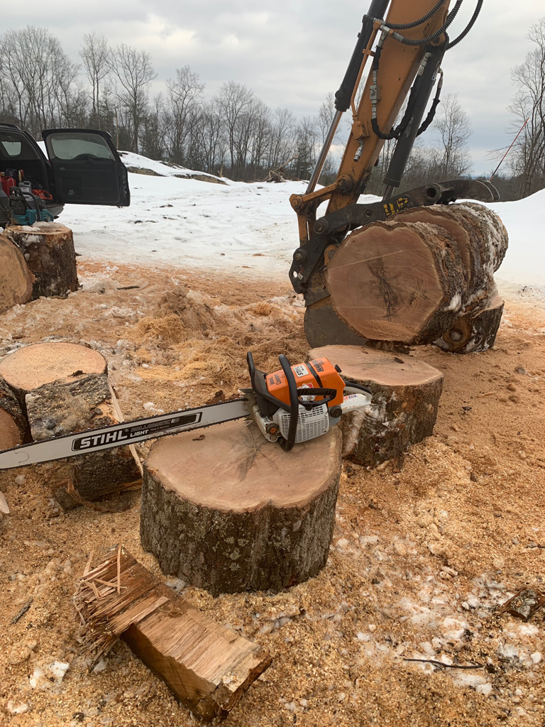

This ain’t no 661 lol. but for what it is it pulls a 36” bar if I need it to,which is rare. I’m gonna turn the H screw in this weekend. She’s got enough tanks through her now.
