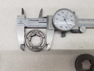

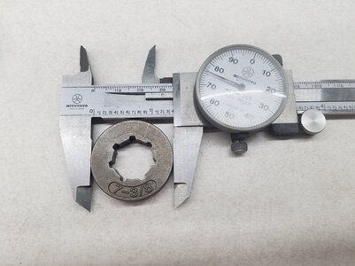

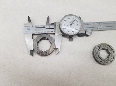

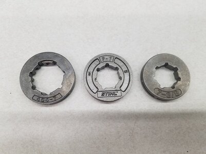

Stihl make a 3/8 LP (Picco) rim sprocket for their "mini" spline. The O.D. of the 3/8-7 LP (Picco) is about 1.435" compared to the 1.375" O.D. of a 3/8-7 sprocket. The LP (Picco) is larger due to the smaller chassis height of the LP (Picco) chain.
It is possible to grind the O.D. of a .404-7 sprocket (1.505") down to achieve the proper O.D. and pitch spacing for the 3/8 LP chain, but the difficulty will be finding a .404-7 sprocket in anything other than the standard (large) spline.
