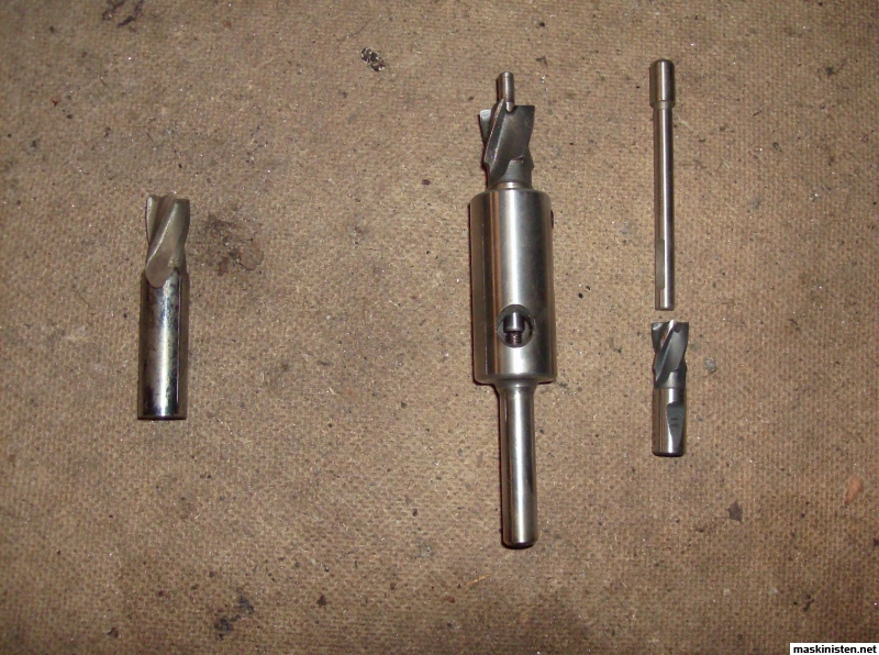

got a 365 special thats leaking around plug. ive tried several new ngk plugs (bpmr7a) and still will not seal, anyone had this problem or have any ideas? threads look excellent.

You need one of the two on the right. Dont know what they are called in änglizch.
You can if you are damn good with a grinder make one with the right size drillbit.
