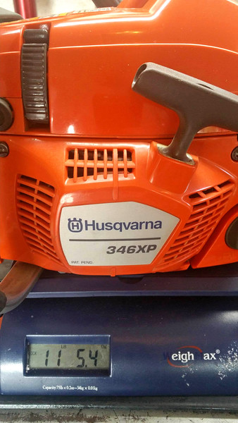

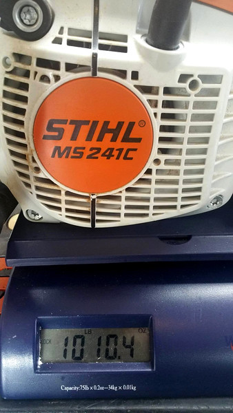

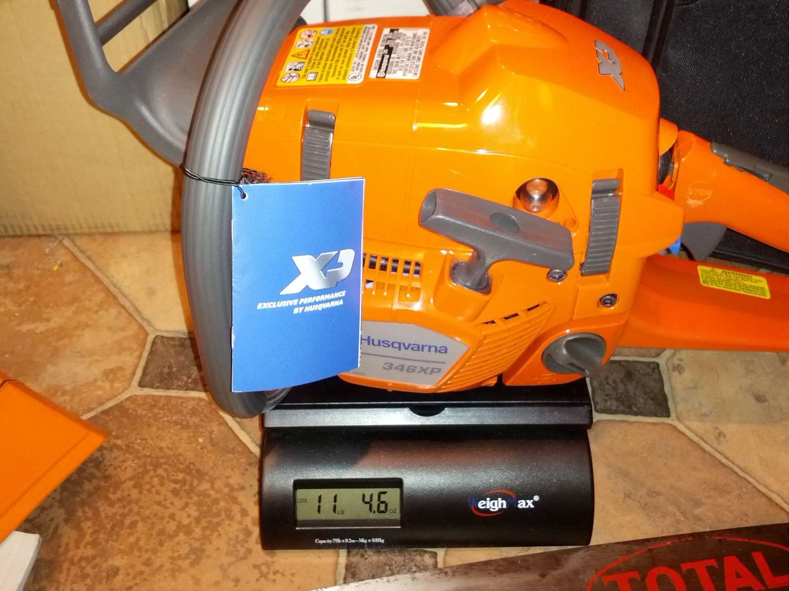

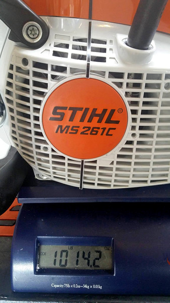

pics of saws weights I have saved http://chainsawrepair.createaforum.com/chain-saw-weights/
Should be enough there for ya to compar. Thats the T2 NE 261, Not the heavier OE one.
I don't care as much about what a scale says myself, it's more important to me what my arms and back say, they say out of those saws posted the 261cm vs 2 had to go as I prefer the handling of the huskys. Power head weight alone is not the only factor at play; type/size of bar and chain, run time, handling, fuel economy, and other features all come into play. I don't mind the 241 and have had a few and still have a ported one, it's light enough(with bar and chain) that the handling isn't a big deal, and it sips fuel. Not sure what's up with the weights between the 241 and the 261 vs 2 in the pictures, they never felt that close to me.

I was only correcting the guy that said the 261 weighed a 1lb more. I was telling him only the OE was that way.
I dont give a rip about weights either. :p
Heck my choice of 71cc weighs more then a fat bottom girl 441. :risas3:
Heck stock for stock give me the 550 and 545 over a 346 OE and NE. :D
241 261 T2 were both weighed by same owner on same scale, even the 346. ;)
