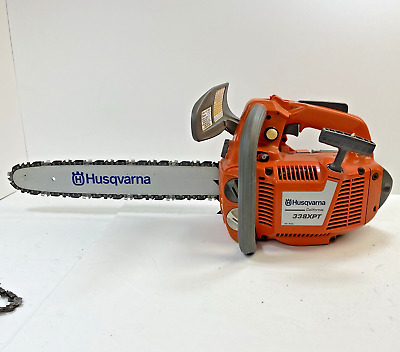

So I've got a husky 338xpt California edition. I'm trying to get it switched over to .325. I've already got the bar, chain, new clutch hub and sprocket that change it over from a spur type clutch hub to a rim sprocket.
Does anyone know where I can get an oil pump drive for this saw that will work with rim sprocket type clutch hub?

If anyone else is ever looking to convert their 338xpt from a spur type clutch hub to a rim sprocket style setup search for parts for the newest model 339. That's what I had to do although the parts haven't arrived yet I believe they will work.
I take this statement back. As bad as I hate it. I just got an email from the place I ordered the oil pump drive and they said "the manufacturer discontinued the item you order several years ago, and we can longer get them". So it back to square one on trying to find an oil pump drive to convert to a rim sprocket type of setup.

It looks like the part I'm after is Husqvarna/Redmax Part# 503789204 if anyone has any access to any parts.
Keep your order in place, because sometimes they do runs of previously NLA parts
