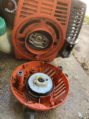

My trimmer drive got stuck with the pull rope not retracting. I removed the pull rope assembly and got the rope to work and reassembled the unit. So now when I pull the rope, it doesnt enguage with the engine. I must have lost a part or something. have I done wrong? Photos included.

Looks like the paws are missing.
But, don’t see any in the ipls

Oh yes, you are right. I remember something like that, but I have misplaced them or put them in a "safe" place. I'll look for them again or they might be available locally at my local lawn equipment shop.

The local shop didn't have any in stock,but they kindly gave me the part number (503-873305 Starter Pawl) I still haven't found them in my work area and I haven't been able to find them online either.
Could someone with better searching skills please help me find a source for them?

Thanks Shane, I went ahead and ordered the OEM unit. I still have no idea what I did with the originals. Oh well 82 isn't old it's just a number.
