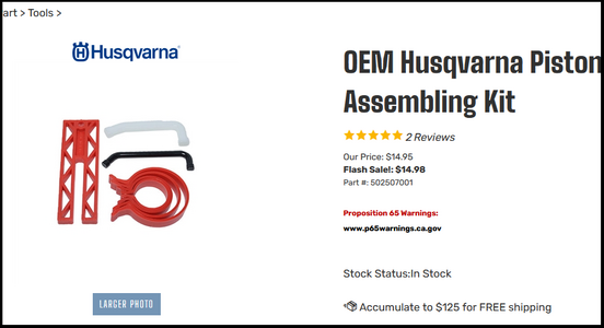

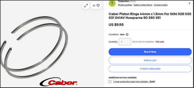

Bought the 350 new around 2002. Great saw for the bigger jobs I did on my farm in Kansas, where I no longer live. The "Big D, and I don't mean Dallas...". But it can still be handy when big oaks die in Northeast Illinois, to be converted to firewood. Won't start, but it sat for too many years during the Big D aftermath... Started looking for carb clean/overhaul videos. Ran across Matthew OIson's many great videos, especially to learn about the air leaks which can eventually affect 350's. (And found this forum in the process.) Don't believe it has the leaks yet. I have accumulated parts for the TLC it's ready for- carb kit, clutch drum/sprocket, the boot with metal clamp for the potential leak at the plastic clamp, etc. (I'm not interested in any "porting" or compression boost- stock performance is fine.) Might round-off some edges as Matt suggests in his videos, once I'm holding the head. Will see...
My question is this: regarding the potential air leak between that next piece down, the bearing cup or whatever, and the crankcase? Matt says this happens if the bolts came loose. Do I need to pull it and re-seal if there is no leak? What about removing the bolts one at a time, using blue loctite, and reinstalling them to proper torque? (I have a shop manual but haven't searched for those torque specs yet.) I'd rather stop at removing and re-mounting the head, if I can stop there.
