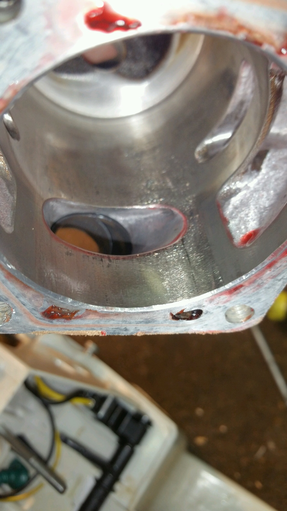

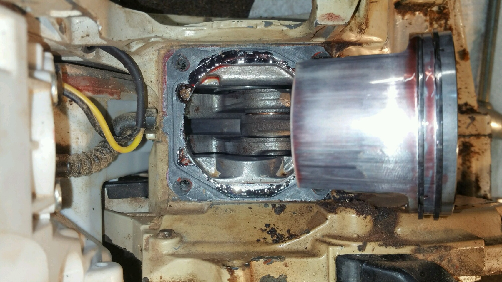

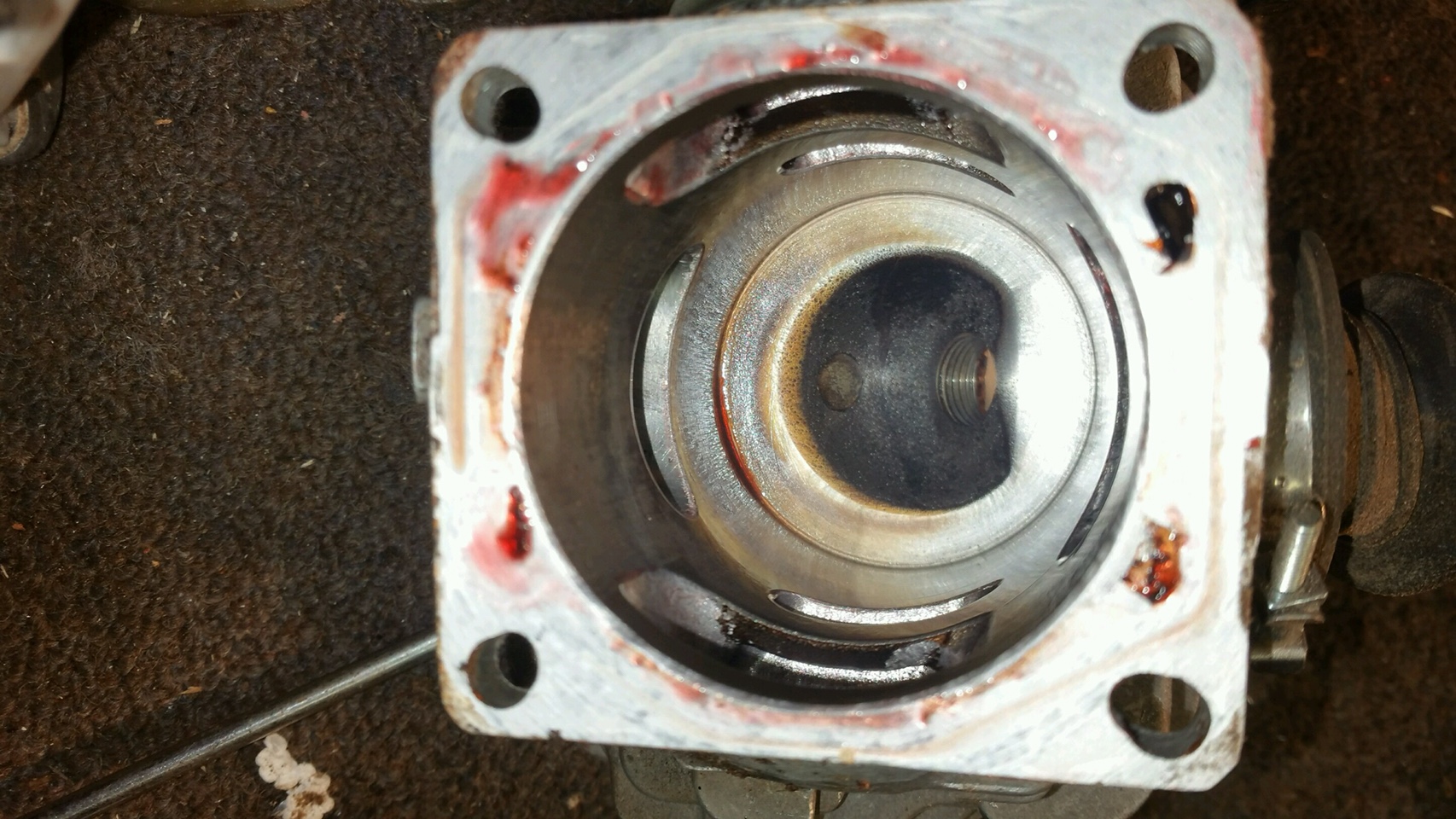

Husqvarna 272 after being ran on Red Armor at 50:1 for 18 months. Before that was ran on brand whateverischeapest for 20 years, mostly orange bottle Stihl. Was very carboned up when I switched to RA, engine was this clean when I took it apart for new bearings. Also, the carbon smear was there when I got the saw. Have since switched to 32:1 and no carbon buildup to report.
My experience has been AutoTune and M-Tronic do not like Red Armor at 32:1, too thick, the computer cannot adjust far enough. Seems to be no problem at 40:1 however.
