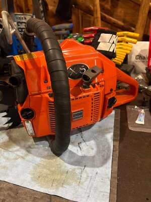

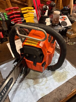

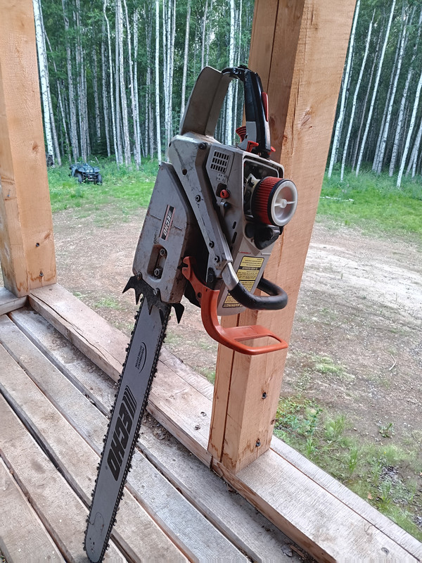

Hi all, I have a cs 8000 that I've been sorting out. Fixing things I dont like.
The handle is too small and would like to wrap it. What're yall using? Can I go right over the existing rubber, or do I have to cut it off? I've notice there's dedicated chainsaw handle tape and all sorts of other types for baseball bats or whatever.
So far I've upgraded the pathetic felling dogs, ported it, advanced the ignition, opened up the muffler and swapped on a larger HDA 45 carb with CS 680 filter/intake. Besides building a taller filter cover, handle wrap is the last thing needed.

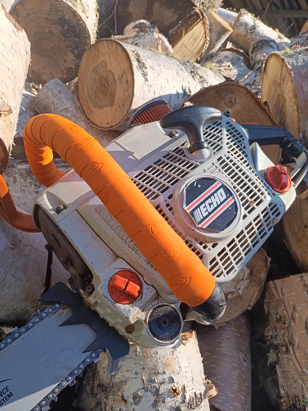

That bike grip tape increases diameter a good bit to , if that’s what you want to ,
Thanks, just bought a coupla rolls of that Cinelli orange tape. Looks grippy. I dont mind a smaller handle on something 60 cc, but a hefty 81 cc's it should've been a larger diameter handle.

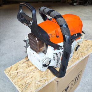

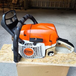

I find the hard stihl plastic is very slippery, esp. in the cold or with double gloves on so i wanted grip....found 1inch-wide 'grip tape' used for the leading edge of stairs so you don't slip on them - basically like course sandpaper with sticky tape on the back. By the time i wind it around like a tennis grip it's perfect for what i wanted. I got a whole roll for a couple of pounds so should do me for years...

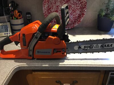

I use sports tape & black vet-wrap, its comfortable but the vet wrap doesn't hold up very long.
