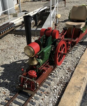

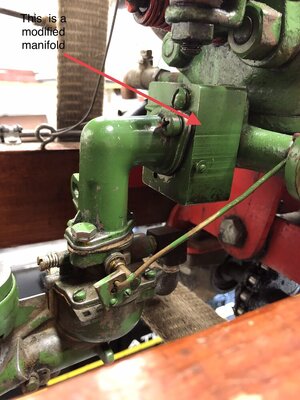

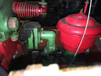

Well, we are trying to convert a FairBanks 1 1/2 HP 1 lung throttle governed engine to a new style carburetor, it was fitted with a Flo Jet and at one time it did run , ( I never saw it) Flo Jet leaks and we want to get rid of it and need something compatible, we will
Modify a manifold , my figures show a 50 cu I engine , the factory original carburetor/fuel mixer is long gone although they are still available, for a price. Pics of Flo Jet. Any suggestions.

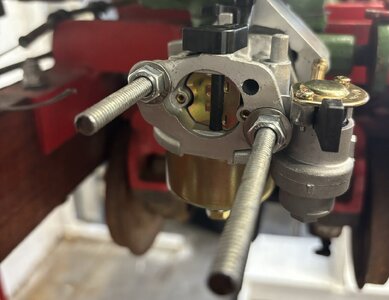

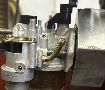

I have a Honda GX 160 mounted on it now, but i think it’s to small.IMG_4431.jpegIMG_4433.jpegIMG_4433.jpeg
