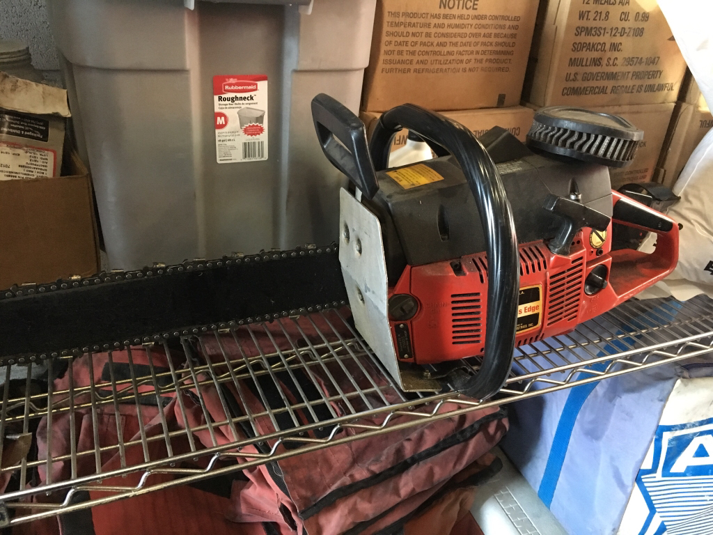

Here is a pic. Not sure if I am going to buy it but kinda interested if it goes cheap enough. 575X torque

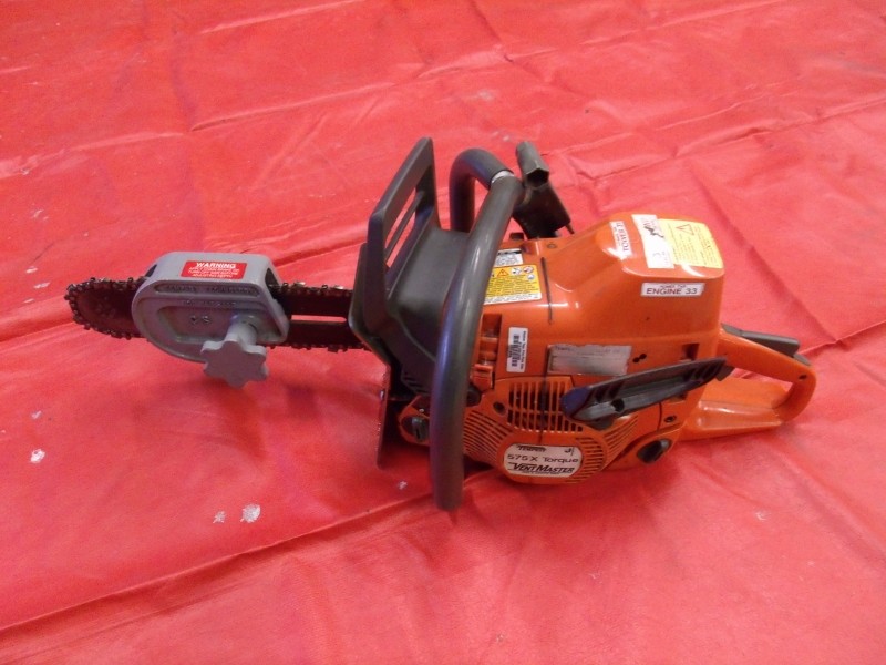

It probably has a course foam air filter, no bucking spikes either.
Uni vent used to be sold thru Bailey's.
I would find a better air filter or modify the one on it to cut wood

Our VentMaster 575xp have the standard husky high top filter, one outer spike, 404 sprocket , solid nose/solid bar 20" and full wrap handle. Some of the saws still have the aluminum case/muffler guard. If it still has the VentMaster carbide chain, that is worth 275.00 by itself.
