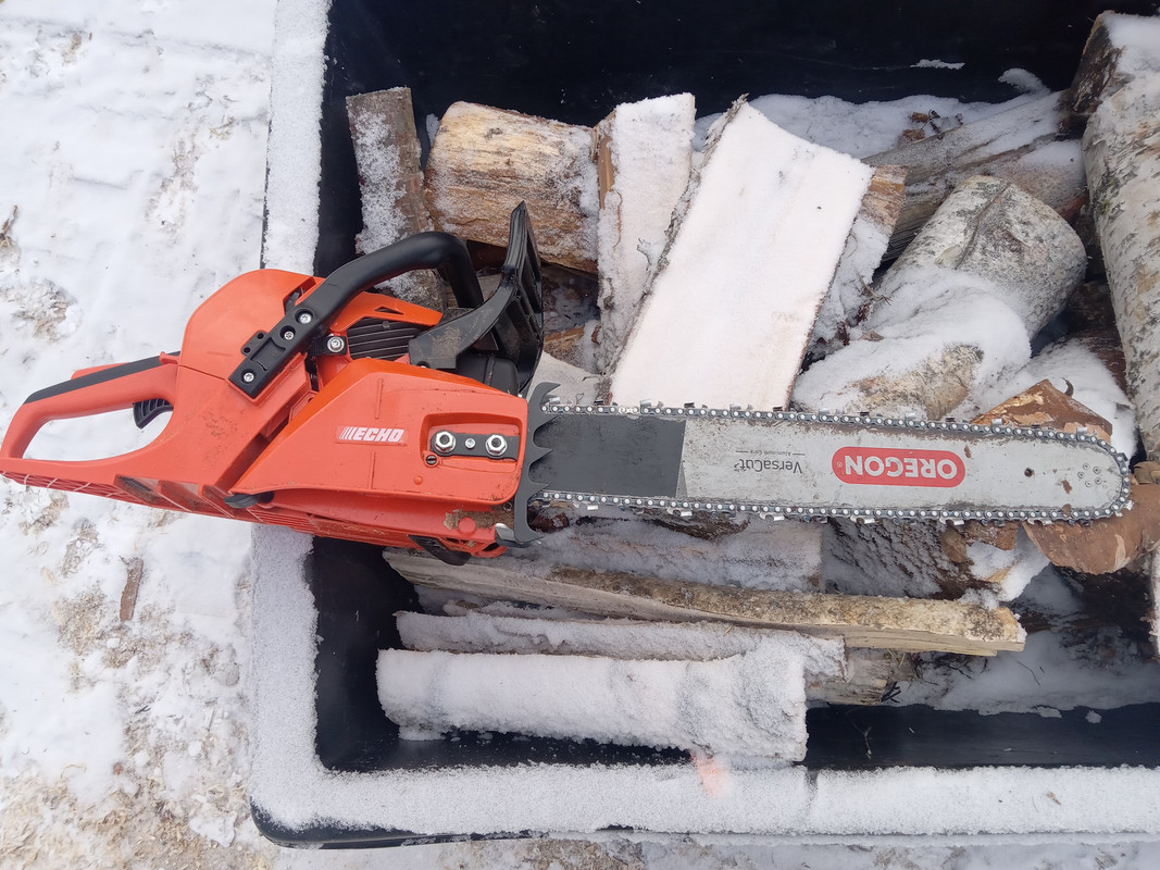

Just tooled up a 590:
Redbeard bar adaptor(stihl bar to 590/620). Free Versacut aluminum-core bar I found in a sawdust pile. Exl chain off my 3 yr old spool.
Walbro 86-578-1 fuel nozzle, carb limiters filed off.
Clutch-side felling spike ( oem echo acsessory).
Base gasket delete, using threebond 1207d sealant on the base.
.015 off the flywheel to advance the ignition timing. Don't like anymore ignition advance than that on the gas i get hear in Alaska. Some of these youtube goobers, you can hear "cackling" in the saws in the cut: too much ignition timing.
Muffler opened up.
Anyhow, a 590 from this seller, you won't do any better. Most smiles per dollar.......

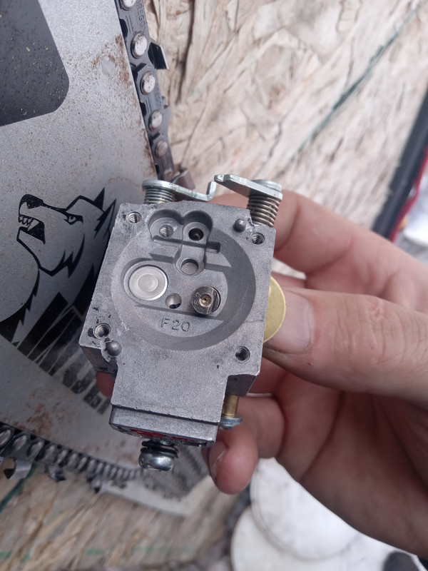

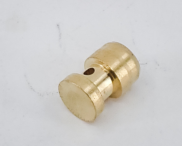

The stock nozzle has an additional fuel circuit that prevents the saw from hitting those peak rpm's. You can feel it in the cut, this high-speed "burble" that holds the saw back. The walbro replacement eliminates that "go rich" safety circuit so you can tune the saw where you want it.
Here's the stock nozzle. Fuel coming into the side, then additional fuel coming into the bottom:
$2 fuel nozzle, no extra fuel circuit (picture from traverse creek website):
