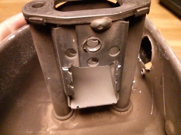

Fixing the 7910 SLR muffler helps a little but it's not a huge improvement until you do the porting, coil, carb and muffler. If you're going to run it mostly stock there's really not much difference between the two in stock form. This is a SLR 7910 muffler pictured from the back. You can see you are restricted on the outlet size but the design is to make a reduction chamber a keep a more back pressure on the unburned fuel mix coming in so you get lets fuel slip and a more complete burn. More restrictive than the 7900... Yes but only a little. You wont see the benefits of removing this until you moddify the carb to push more fuel and air through the whole system.
SLR removed:
7900/6400 muffler - Keep in mid that there is still a diffuser sleeve inside most of the 7900/6400 mufflers that create the same slow down in exhaust gas. Just a hair better than the SLR's. pic of modified 6421 below with diffuser cut open. I just wanted to dispell some of the myths on the 7900/7910 changes.
