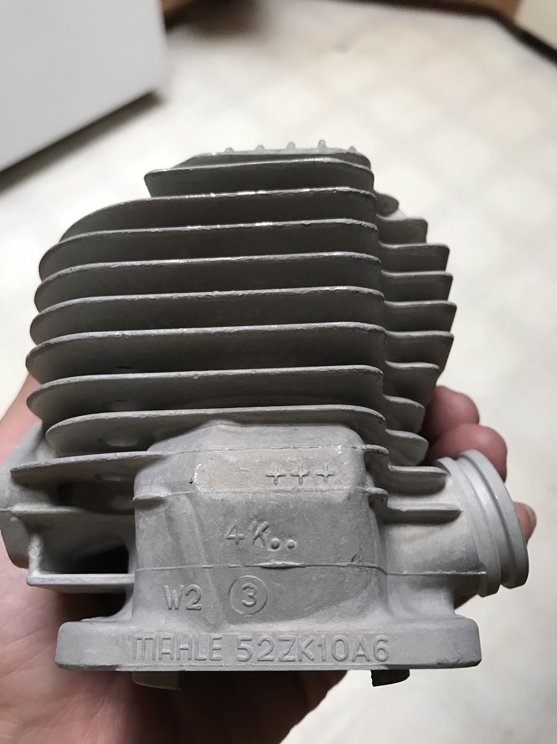

Is this anyone's here?

Second picture says Mahle 52ZK10 on the cylinder base.
I could be wrong but that indicates a 52mm cylinder bore which would make it a PS-7900 cylinder.
PS-7300 is 50mm, after market big bore is 54mm.
Piston is scored, would need a new piston kit.
I think the Buy Now price is too high in that ad.

Thanks for pointing that out, Wilhelm. It got me thinking, since that is also what my cylinder has written on it, so went ahead and measured the cylinder. It is indeed 50mm. Would have been nice if the eBay cylinder was 52mm! [emoji2]
I agree, the BIN price is too high. Gonna wait it out a few days and see if a minimum bid will do the trick.

I did say that I could be wrong! ;)
I have a NIB OEM Dolmar PS-7900 P&C kit, if I don't forget I'll dig out pictures of it or take a look at the cylinder and see what it says.
Might also try to see whether the markings are visible on an assembled saw, if so might take a look at my three girls cylinder bases.

Here's a few more pics of the cylinder from eBay. Didn't see any scoring but looks like there's some pitting.

Looks good bud id. Jump on it.i just got a 6100 same thing needed p/c fairly new saw.i think imo its them thin 1 ring pistons

That may be a 52mm bore. I think the extensions are thicker on the 50mm.
