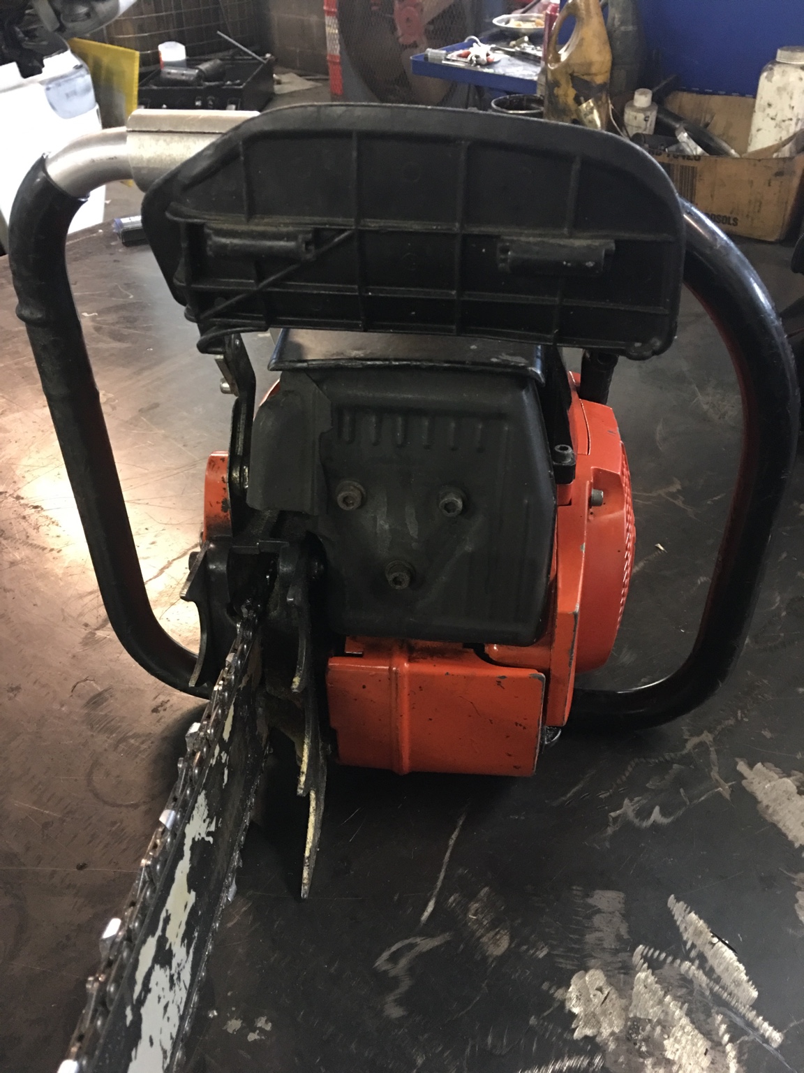

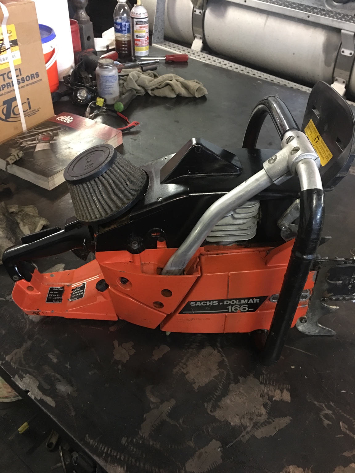

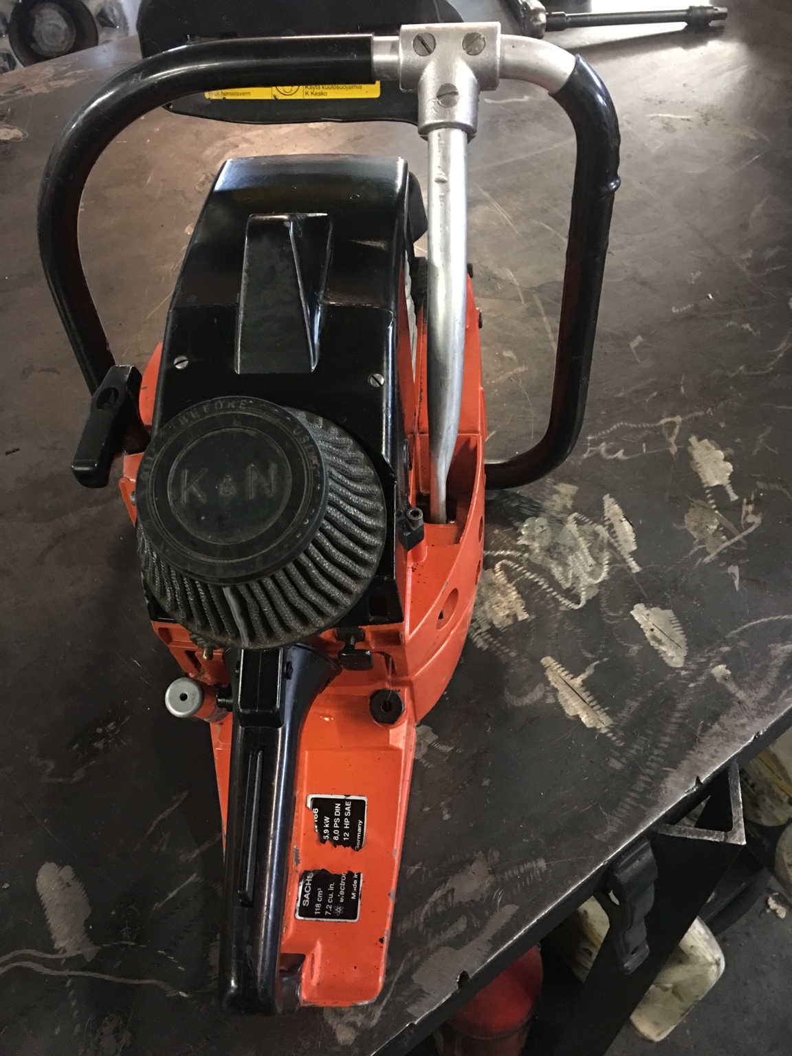

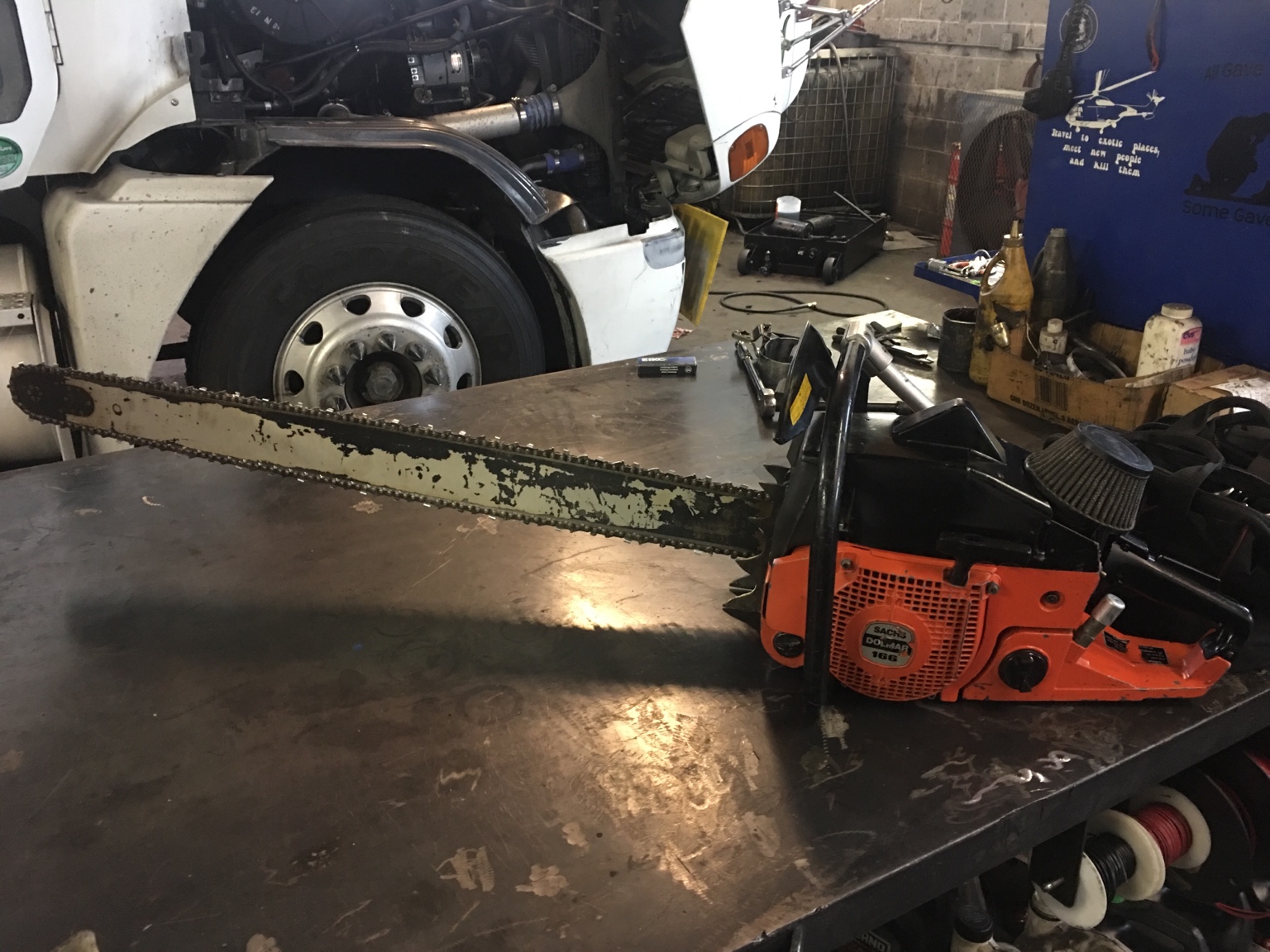

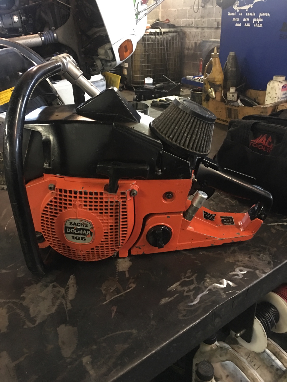

Cleaned it up a little and took some better pics. Now I'm on the hunt for an m3-3/4" screw to use for the idle adjustment. The factory ear does not reach high enough to hit the screw that's in the saw itself, but the carb body is tapped for an m3 screw. I've found a 5/16" one at ace hardware, however it's not long enough. I also picked up a full chisel chain for it today. I love how unlike Stihl it has not only a 36" usable bar, but it actually has a 37-1/4" usable bar. Anybody know the part number for the K&N air filter? It could obviously use a new one of those too. I thought about just getting one of the green foam filters for it.
